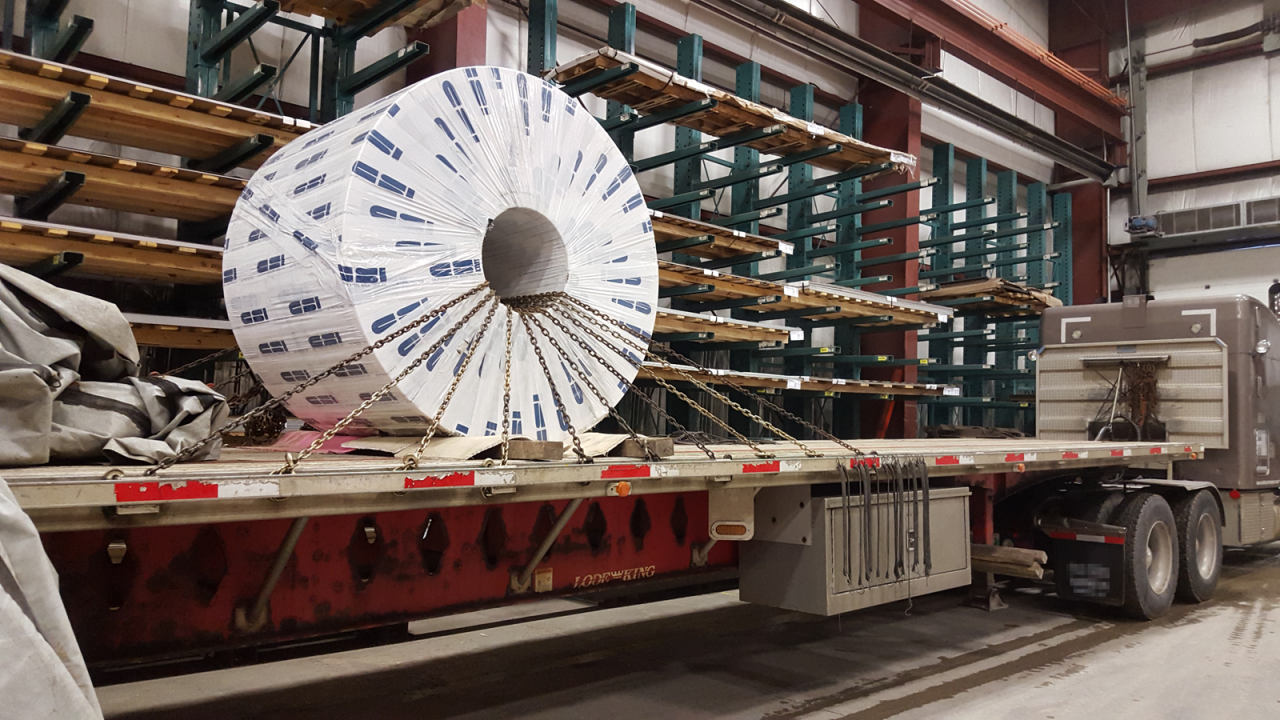

    All my company hauls that specifically requires chains are crushed cars, steel coils and steel beams (i.e. I-beams, not pipe/tube, that we use straps for). We use 5/16" grade 70 (I'm assuming, might be better) and tend to use 2-3 more than the required minimum. Personally, I much prefer to haul loads that can be strapped rather than chained.
    I delivered a coil a couple months ago that weighed in around 46k, and the pickup driver secured it suicide, with ten chains running indirectly through the eye to both sides of the trailer and bound on one side. Definitely overkill but with a coil of that size, and feeling the weight shift under even slightly moderate braking, I'm glad he did.

    That's a good way to destroy aluminum stake pockets...

    If you look close it looks like there is only a single spool between pockets. I much prefer 2 spools between pockets because that securment is way to spread out to do much. The last two chains on each side are not really contributing much to the load IMO
    EDIT: I looked again and it looks like there are two spools between pockets but maybe the pockets are on four foot centers or am i just crazy this morning?

    I have no prob with someone putting 10 chains on a coil. so long as they are not in front of me :) 1 or 2 then pull away to do the rest please.
