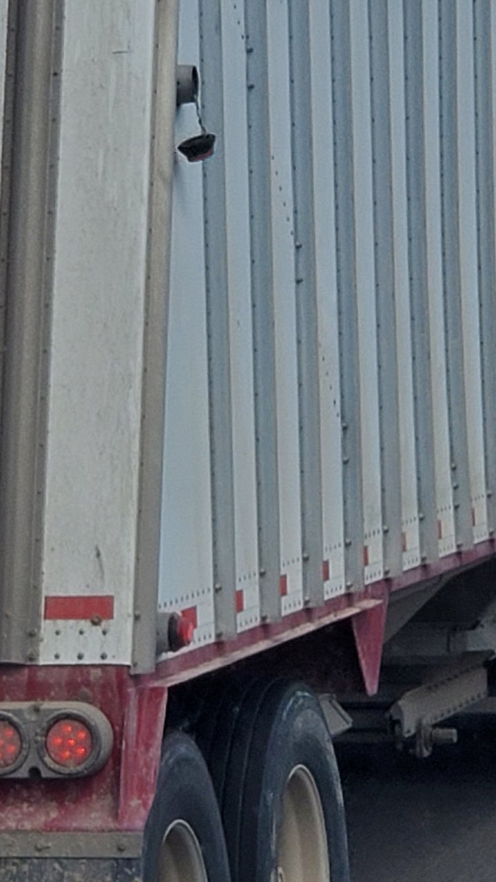

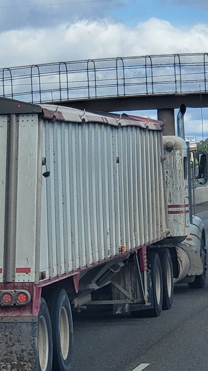

    Okay so I passed this truck NB I-15 near the exit for 2700 N near North Ogden/Plain City area and his light on the trailer was just hanging out like this, maybe not such a big deal I guess even though it should be working BUT I seen one exactly like this at that Pilot I stayed at this past week in New York.....and it was a HAZMAT tanker truck. My question to y'all is....how safe does would that make you feel?? What if there was an electrical short on the tanker or the wiring was exposed and it got rained on and caused a fire? I'm pretty sure that driver sure as shi# wouldn't feel very safe once a fire or something similar happened......unfortunately, I wasnt ever able to get photos of the tanker. 20220503_103932.jpg 20220503_103913.jpg 20220503_103927.jpg

    If it shorted out, it should pop a fuse.

    Lights on a properly wired truck would have a hard causing a fire.
    Wheel end issues cause the majority of fires.

    I wouldn't run forever with that hanging out like that. But its low on my list of stuff catching fire. Like @MLC Adventures said, wheel ends, bearings, brakes, tires.

    Eh happens more often then you think with a dump.....well anything really. Wouldnt be the first time some material fell out of a bucket and banged on a light leaving it only JUST in the hole. I get out and look around and its fine but first pothole i hit it pops out. Usually not a big deal just stop as soon as i see it and pop it back in. Usually replace the grommet too while im at it as its usually a worn grommet that lets it happen.
    As for causeing a fire, pretty unlikely. My fuse would pop long before that happened and ive had water get inside a cracked light before, all it did was kill the light. Theres just not enough current in a marker like that to start a fire with unless your hauling explosive gas or something and already have a leak. In which case you have bigger problems like say the white hot emissions system decideing to kick off.

    I wouldn’t leave it that way on my rig very long and most DOT wouldn’t have a big concern with it either but definitely not a safety concern. Contrary to popular belief things like this can actually happen going down the interstate. I will give the guy the benefit of the doubt that he repairs it the first time he stops.

    I drove brand new trailer where the lights popped out like that. They didn't seat very good in the round hole and a big enough bump and they pop out.
