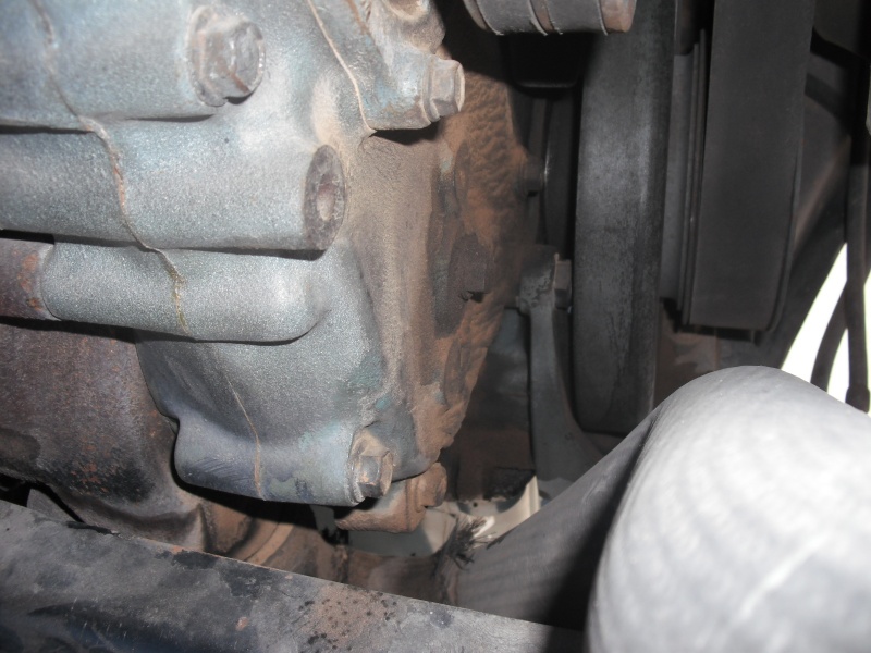

  9. freightlinerman
    freightlinerman Road Train Member
    1,287
    536
    Mar 4, 2011
    Florida
    The only possibility I can think of is, due to the fact the truck is lower in the front and higher in the rear, the oil will run towards the FRONT of the engine. The engine is also tilted to the right(Passenger side) because the clearance is so tight, other wise the valve cover would not be able to be removed.
    I have attached four pictures. One picture shows the oil leak under the air compressor, another shows the leak pattern before I wiped it. A third picture shows a rag stuff up there to absorb oil so it doesn't drip on the ground and finally another pic shows the front case of the engine. I would venture to guess, the accessory bracket for the air compressor is leaking oil. Was the oil pan leaking? Yes, it was.
    Thanks.
  10. heavyhaulerss
    heavyhaulerss Road Train Member
    3,723
    2,040
    Dec 23, 2009
    AL/TN BORDER
    I know this wont make you feel any better, but if my engine was that dry & that was the only leak, I would be happy & not even worry about it.
  11. grump
    grump Light Load Member
    74
    29
    Jan 1, 2011
    PA
    I had about the same kind of a leak turned out to be oil fill tube was cracked the oil ran down block and along pan gasket to rear of pan made a mess .
