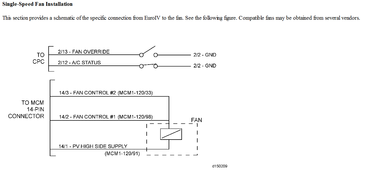

    No, that is not the correct way of wiring in a manual fan switch.
  3. RocketyMan
    RocketyMan Medium Load Member
    549
    336
    Jun 5, 2015
    I don't know what DDEC version your series 60 is because you didn't specify...
    I would check PSL in the A&I guide and do it correctly if you want a manual fan override:
    Elroythekid Thanks this.
