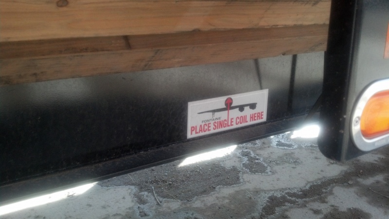

    Look under the trailer at the coil package. On my Fontaine it's just 2 or 3 extra I-beams welded between the rails 1 ft. rear of center of the trailer. Put it right there.
    Another clue could be the sticker "place coil here".

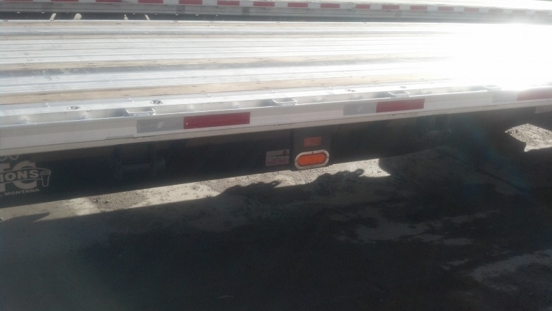

    right there is where the trailer mfg recomends
