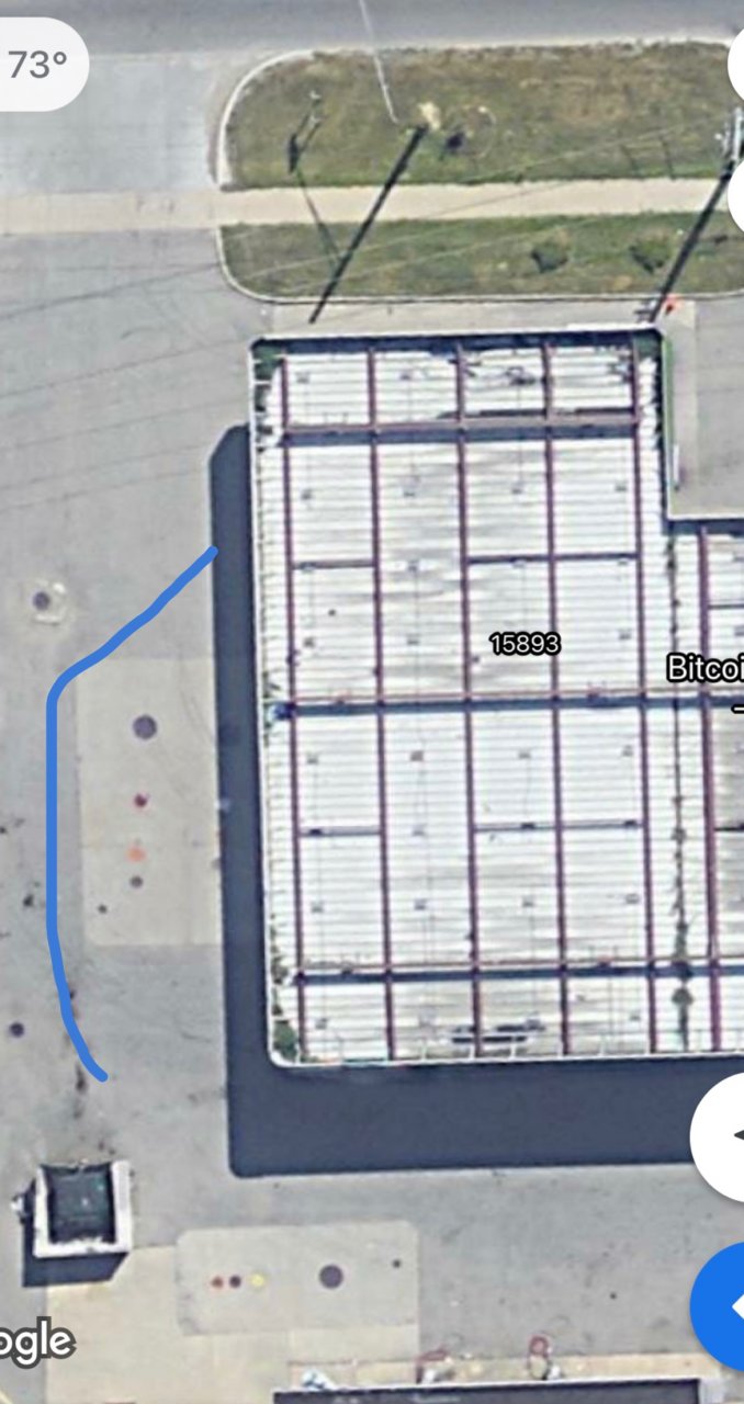

Lastly cone up and speak up. If you don’t want civilians walking or driving by it... cone it off. If you don’t cone it off they will do the stupid thing that you didn’t want them to do 100% of the time. And Speak up be proactive. You saw that guy pull in with the cigarette in his lips parking and he has to walk past your fills to get to the store. Give him a second to get out but if he walks forward let him know because “he forgot” “his bad, he don’t know what he was thinking”, and my all time favorite especially in tiny stations “I didn’t see the gas truck”
When you get good at doing stations and know all your fills park to protect yourself.if you can pull in to always face to inside of the station do it that way therefore you can see any potential threat and that you’re always on camera. We get a lot of idiots that fly into the parking lot doing 20-30 mph. If you can turn your truck at the last second instead of lining up straight do it for example>>Attached Files:
