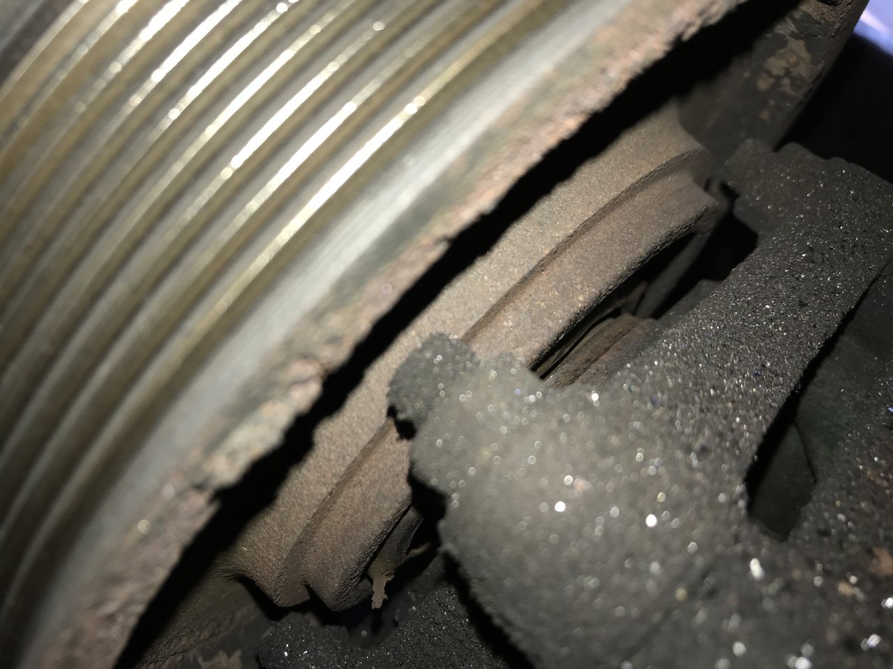

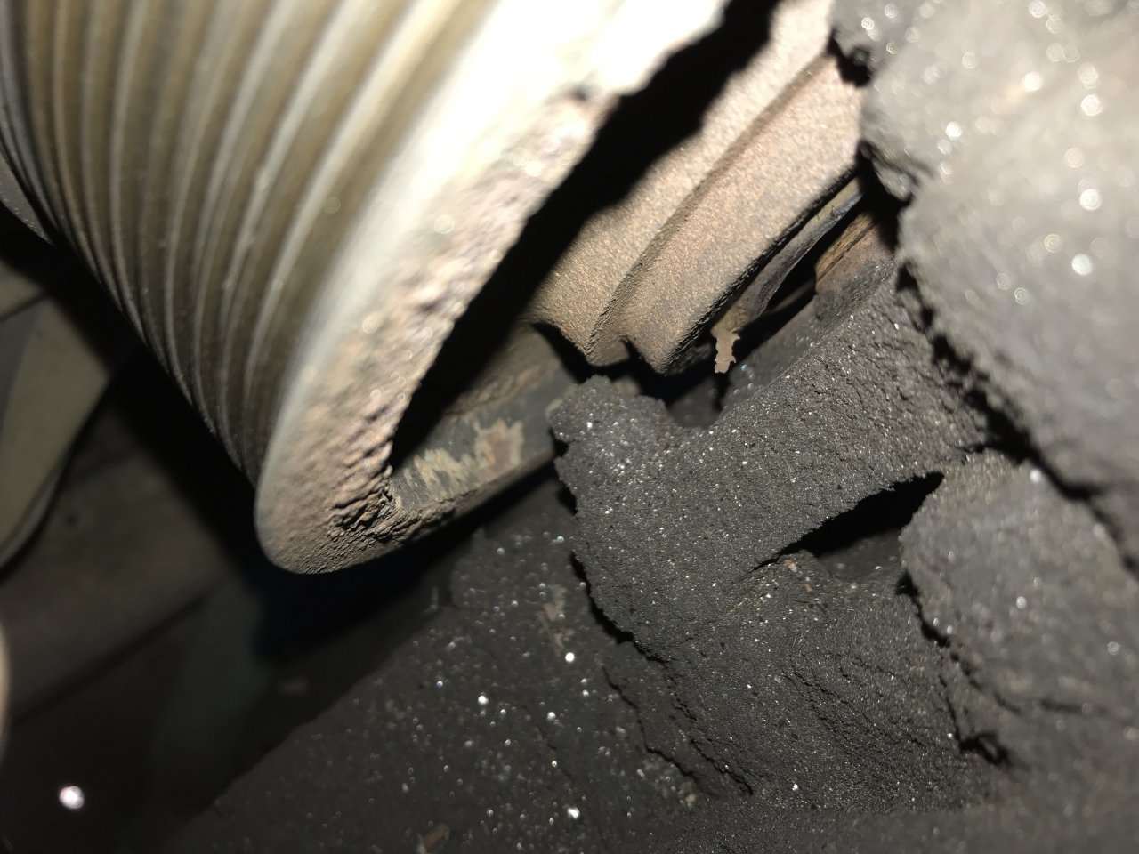

    88353A79-2CB1-431E-B409-1BEBB017DFE9.jpeg AA9F5D4D-689A-414B-9ADA-BDAB3D022143.jpeg
    My problem is I can’t get any wrench onto the bolts with the studs sticking out. The hub is blocking when I try to put a wrench over the studs.
  5. AModelCat
    28,871
    154,581
    Why won't the open end fit over? Looks like there's enough room.

  6. poniikyanion
    poniikyanion Light Load Member
    69
    14
    Nov 23, 2009
    Newark, NJ
    Yes there is enough room for open end wrenches but. All the nuts are very tight and I worry about rounding off the nuts using open end wrenches. But it seems like the only way now.
