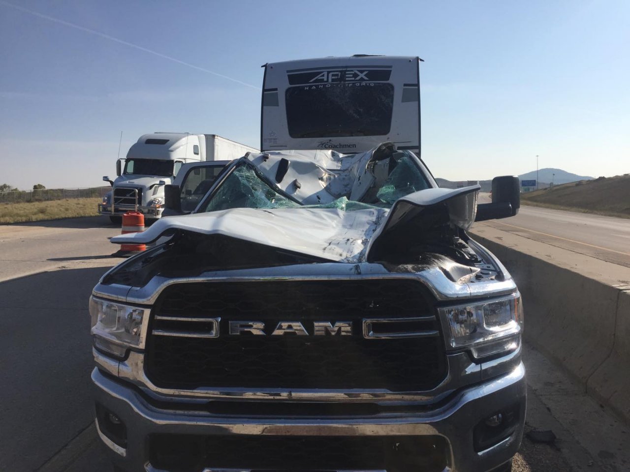

    An East bound semi lost the driver side steer tire at milepost 6 on I-80 in Wyoming. The tire jumped the median barrier and struck the westbound pickup-truck. The driver of the truck was transported to the Hospital.
    I drove past several minutes later, and the semi still had it's brake drum etc... So it should have been shaking the wheel or the driver should have seen evidence of loose lug-nuts with any reasonable pre-trip.
    It was a large carrier so no crazy spikes or other chrome to hide those problems during an inspection. Sure it is possible that someone had installed his lug-nuts too tight and they were just waiting to blow...but with the carrier involved I am betting it was just a lack of proper pre-trips.
    I hope that the pickup driver is OK.
