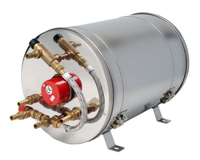

    Found my solution for the hot water heater :) Simplest thing in the world and it won't really use any power unless I use the auxiliary heating element. The water heater will use the coolant from my APU to heat the water tank in a heat exchanger system. I just can't figure out if I want a 6 gallon or 11 gallon tank.
    With regards to dimensions both tanks are 14" high, it's only the length that changes. The 6 gallon tank is 23 1/2" and the 11 gallon tank is 33".
    Here is a link to the hot water tank I am looking at :)
    http://www.marinetec-us.com/solaris-6-gallon-2/
    http://www.marinetec-us.com/solaris-6-gallon/

    I was originally thinking of something like that but having to carry a propane tank in the truck plus cutting a vent hole for it to vent outside made me look for something else. I also want hot water for more than just a shower.
    It's still a possibility I'll go that route, but by using items that keep me to one fuel source, I simplify many aspects of this project, and it stays inconspicuous. I don't want people to guess I have that kind of setup in my truck :biggrin_25525:
    blr300 Thanks this.

    Plus it's all probably over kill for my application. I tend to over spec and engineer the sheetz out of everything, lol. Best part is, the marine products are designed to take a much worse beating than we can give them in our trucks.
