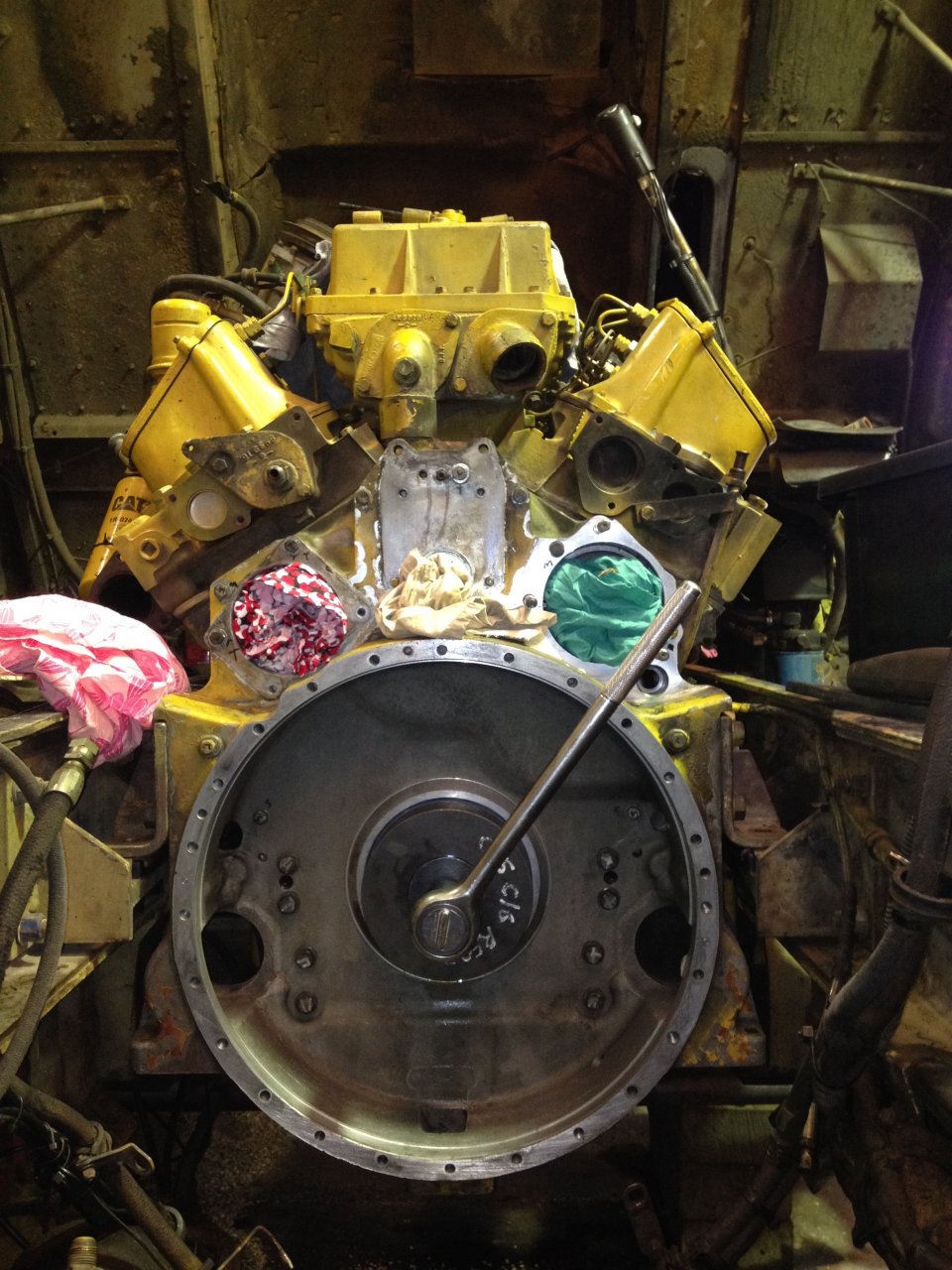

  6. Ozdriver
    Ozdriver Heavy Load Member
    767
    1,390
    Oct 16, 2015
    Australia
    You will need a special installer tool like this one.

  9. Ozdriver
    767
    1,390
    Oct 16, 2015
    Australia
    CAT 3408. The front and rear housings were fretting and leaking oil so after a couple of years of putting up with it I finally pulled them off and got them machined and resealed them. It's a monster job.
