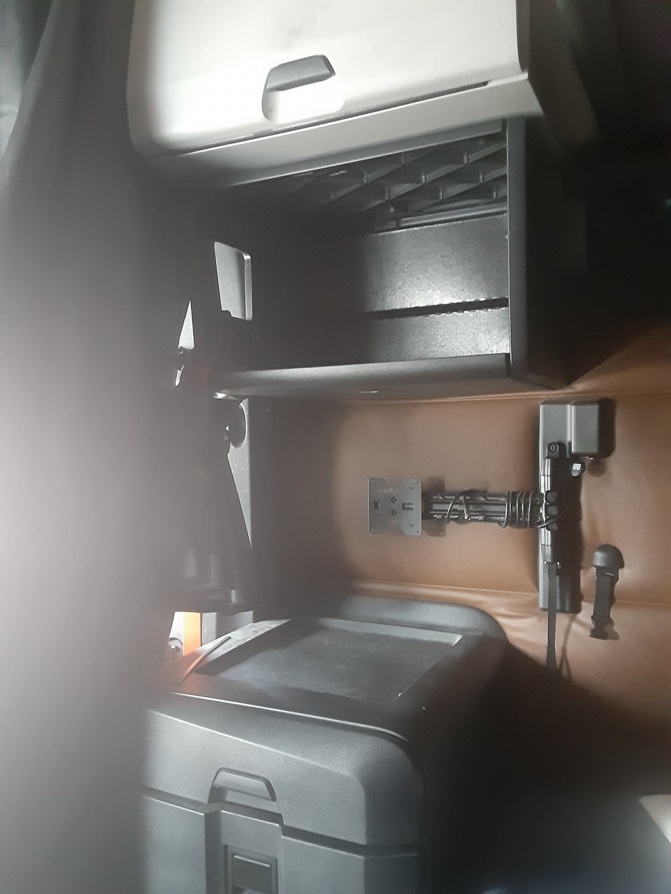

    Also, I am wondering where I should put my microwave and how I should brace it so that it does not fall onto the floor (and get damaged) when I have to take a sharp turn real quickly. interior of semi-truck.jpg
    The photograph above is a photograph of the interior of my truck. At the bottom of the photo is a built-in refrigerator with a flat top. About a foot and a half above the refrigerator is an open shelf compartment. I think that I should either put the microwave on top of the refrigerator or in the open shelf compartment. But if I just set the microwave on top of the refrigerator or in the shelf without anything bracing the microwave, the microwave would surely fall onto the floor every single day, damaging the microwave. I cannot have the microwave falling off all the time. I don't think I want to store the microwave under the bed while I drive and just take it out when I want to microwave something because there is not room under the bed. One I idea I have had was to either buy or make some sort of crate to hold my microwave, and then have bungee cords to secure the crate. But i don't know where I would put the bungee cords. Does anyone have any ideas of where I should put my microwave and how I could secure it properly? If you have a 2021 Freightliner Cascadia with the built-in refrigerator like mine, I would be especially interested in knowing how you secure your microwave, if you have a microwave.

    You're not running the microwave while you're running down the road, so it doesn't really matter. I occasionally have to reposition the turntable, but that takes all of 3-4 seconds. I've got a 2015 ProStar, but nearly identical interior layout to yours. Mine is strapped down on the passenger side cubby/table area, and it doesn't move whatsoever. I'm getting a dorm fridge soon, and it's going to be strapped down on my top bunk. Having a dedicated real freezer is going to be life-changing when it comes to driver happiness.
    Oh, and I got the cheapest microwave I could find on Walmart's website, I think it was like $42 shipped.

    There so cheap, if it lasts a yr. ?? Should last longer. Small one might fit in the shelf above fridge.

    That shelf is made for a microwave. There should be a strap in there to secure it down.
