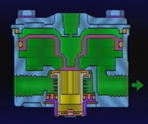

    Here's a R-12 Relay valve that is in the "off" position. No signal air pressure above it from the treadle valve.

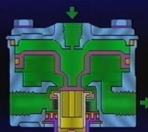

    R-12 "on" position. Signal air pressure from treadle valve opens a supply port. Air flows from primary tank to supply port in the R-12 and out the delivery port to the Service Brake Chambers.

    "Balanced" position. Air pressure equalizes above and below so no air is being sent to brakes, and no air is being exhausted at the exhaust port. So basically your holding the treadle valve at the same position. Brakes are being held.
    I'm thinking the same thing happens with the R-14 valve that operates the Spring Brakes in that diagram I uploaded. The push pull valve puts the relay valve in a balanced position and the Spring Brakes are released, and air is kept inside. Make sense? Maybe?
