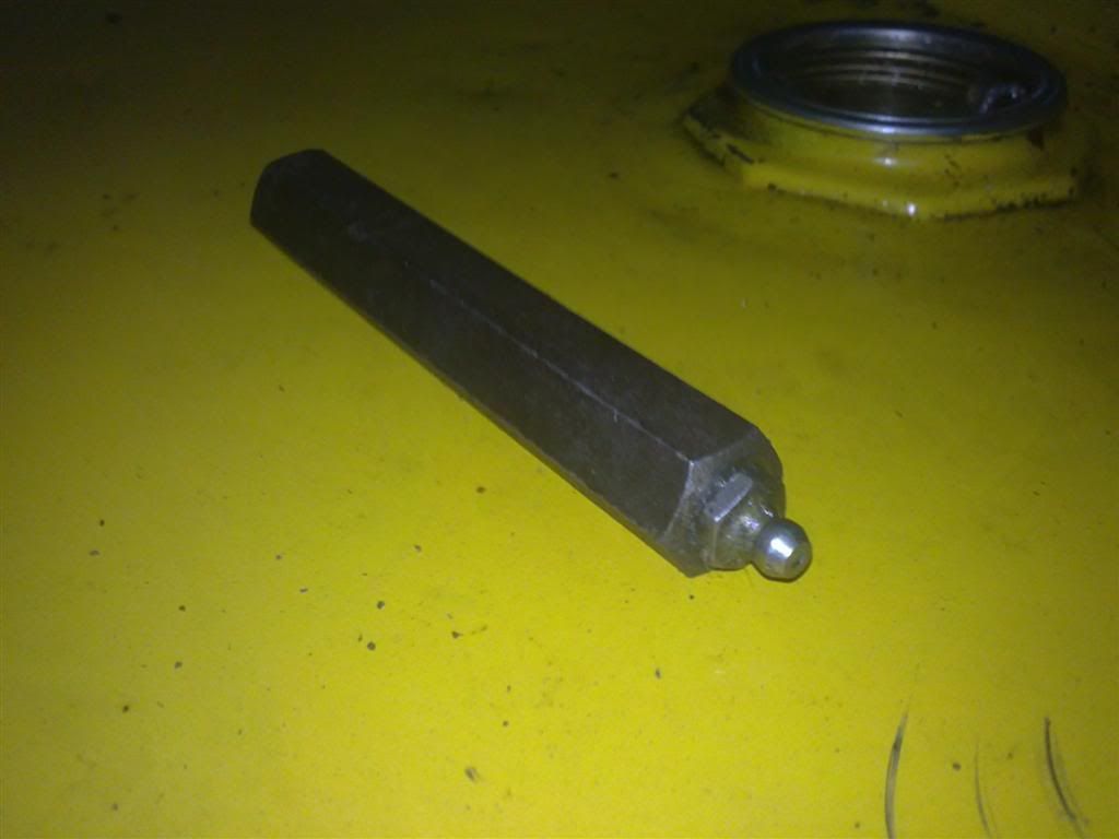

    my father have another mercedes sk 6x4 3axle tipper before few years and pipes to front axle were blocked for a years and only 3months after we bought truck we need to change front axle
    so to preventing problems and inspecting we have this and you remove hose and put this and lube it manually every few months
