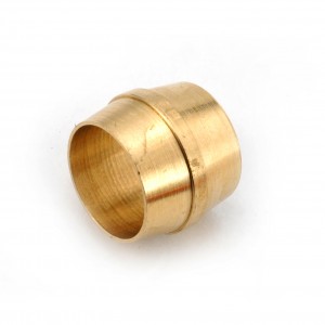

    I have a very bad taste for those. The first ones I know of were on CL9000's. Ford must have had a major accident claim. A guy in the shop was put on one to replace every fitting throughout the truck.
    Three weeks latter he was finished. Thanks you did a great job! Will you get the other 9000 parked in the back and do it the same way?
    After almost accepting them as improved version and good to use I went on a service call today. Plastic piece of junk broke in half and lost all the air pressure.
    I have to live with them in places but will always use DOT compression fittings when possible.
    rollin coal and xsetra Thank this.

    never seen a brass airline connector with o rings.
