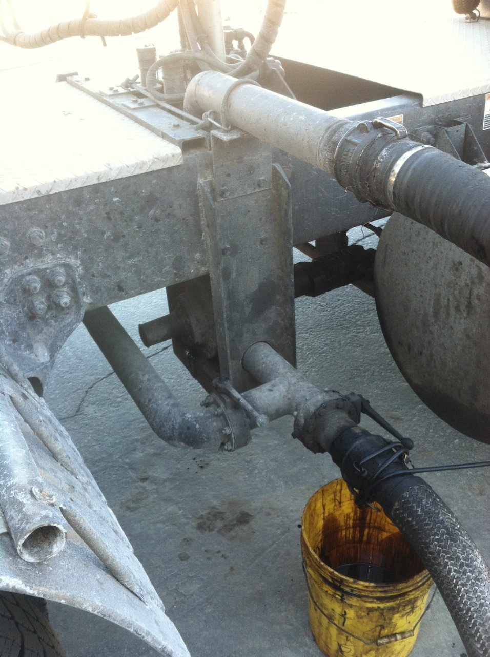

    You can use air from glad hand but a separate air compressor Pto driven is much better.....
    Yes there are plenty of hyd options for driving a product pump and or air compressor......
    F2CB3727-EACE-423F-B010-909814DDD99A.jpeg B5A6CFBA-3840-4522-96C1-0E81AF249ED5.jpeg

    Do you happen to have a picture of what the air compressor set up looks like? Like where you hook the line into, is the air compressor unit part of the PTO pump or is there a separate piece that would need to be installed? Thank you for the pictures provided

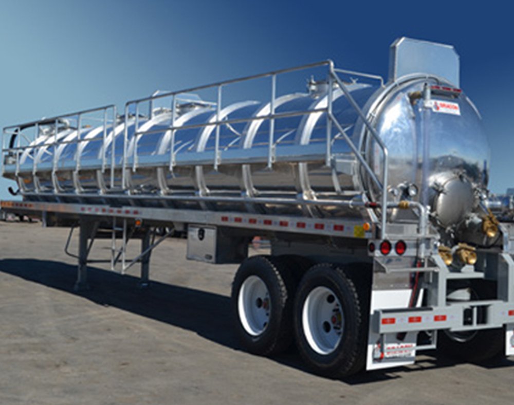

    What application is the vacuum pumps they sell used for?
  7. Cat sdp
    Cat sdp . .
    20,819
    71,604
    Apr 8, 2012
    Orion's Belt
    Like a septic truck that vacuums up the liquid to self load ....

  9. RockinChair
    RockinChair Road Train Member
    4,918
    12,257
    Feb 19, 2012
    CC, TX
    Vacuum trailers are often used to haul things like grease trap and grit trap waste or oilfield produced water, but they can haul hazmat and hazardous waste. I have used one to transport oil-based drilling mud, which was Class 3 flammable liquid.
