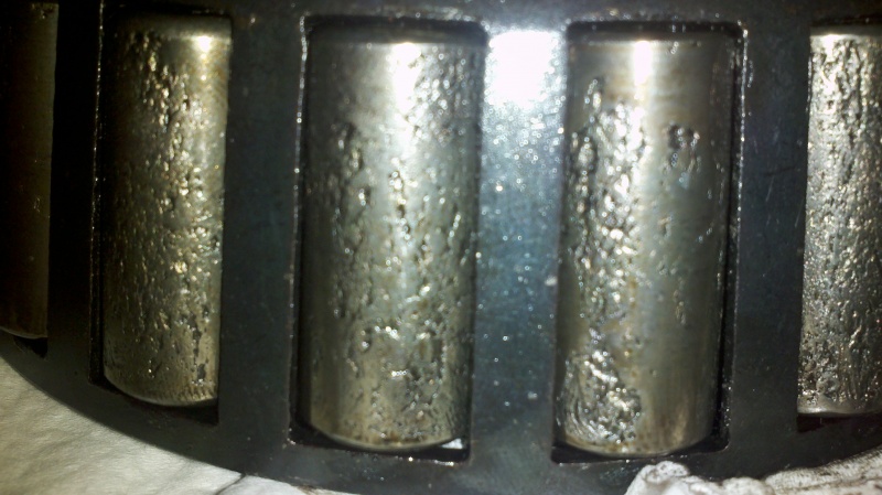

    Hello, They were on a 2006 Transcraft 48 Combo flatbed. I will post pics of bearing/race damage. We discovered it while changing brake shoes. The hub had so much play from wear. We immediately put it OOS till we could find parts and replace. Mechanic does it by "ear" so to speak. He has over 25 yrs experience and does excellent work. These were the original bearings by the way.

  10. blanco
    blanco Road Train Member
    1,221
    296
    Nov 20, 2009
    Gwinnett County, GA
    Here is damaged bearings. The whole bearing was like this. Ouch! Pitting really bad.
    Hyatt HM218248 Made in China
    Contaminated oil? Bad/subpar steel in bearing manufactoring?
  11. Krashdragon
    Krashdragon Medium Load Member
    651
    305
    Apr 10, 2012
    Cleburne, Tx
    Dont know about truck bearings, but several guys on a Harley forum have posted similar pics of Chinese made m/c wheel bearings that are badly pitted.
    bearings were only a couple years old, mostly on rebuilt shovels and evos...
    Replaced with Chinese, same thing again. Replaced with good US or good Japanese, no prob.
    Just sayin.....
