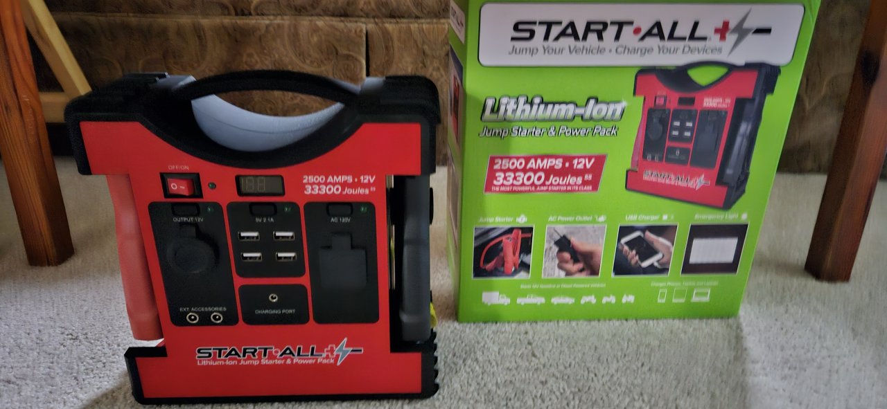

    I bought this last month.
    Cost and quality is a bit more but you get what you pay for.

    Ditto above.
    Best jump box I have seen so far.
    We have 3 and they are used daily. So far almost a year with no issues.

    I have one similar to that. Works like a charm.

    Charges quickly. Less than a half hour w wall charger. May take longer with a DC or USB charge.
    Need to charge every 6 months to maintain warranty.
    Lith ion battery good for 500 jumps according to manufacturer.
    Our shop uses a 10,000 amp unit bit that was a bit to pricey and overkill for me.
    Best price I found.
    Goodall Start All Lithium Ion Jump Pack 12V 2500 Amp JP-12-2500T

    I can tell you they will jump a completely dead tractor with 4 group 31s. And more than one back to back.
    Ours never get drained and are always plugged in when not in use.

    $159.00 is a good price.
