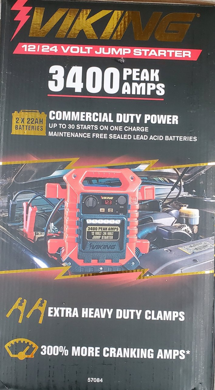

    Got caught too many winters where truck wouldn't start and needed a jump.
    Last time road call guy said he used 24 volt jump to my truck.
    I got one of these portable battery jumpers.
    Can select between 12 or 24 volt.
    What do you suggest?
    Also where would be the best hook up spot on a Freightliner Cascadia.
    Thank you

    Lucky he didn't fry everything on your truck. Very dumb to try and boost a 12 volt system with 24 volts.

    I read there could be danger using 24 volt.
    Road call guy said he does it all the time on semi trucks, "gives it an extra boost".

    Fry the system. Guess it is not his system, so who cares.
    12V works no problem

    That man is an idiot.
    It's not about voltage that the power comes from, that must remain equal on both ends, it's about the sustained amperage available.
    Would you plug a 110v drill into a 220v outlet to get more power?

    Pretty sure the Cascadia has remote terminals for jump starting. That would be the best spot.
    But don't use 24V mode on a 12V system. That's probably a good way to fry your computer.
    I have a NOCO battery jumper for my car. Those lithium-ion batteries are wonderful.
    Hook it up, and start it up. Just that quick. No waiting 15 minutes with a truck hooked up with jumper cables.

    If you have jumper terminals on the frame rail, that's where you hook up. If not, just hook the red to the terminal with the large red sheathed cable coming off towards the truck and the black to the opposing terminal with a black sheathed cable leading toward the truck.
