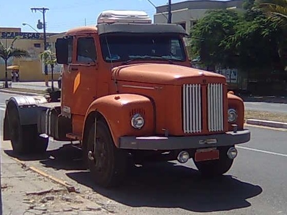

    Go old school and put a swamp cooler on that thing... Just take it easy when cornering or the water will slosh in to the cab and it usually ends up giving you a good shower in the process... Lol
