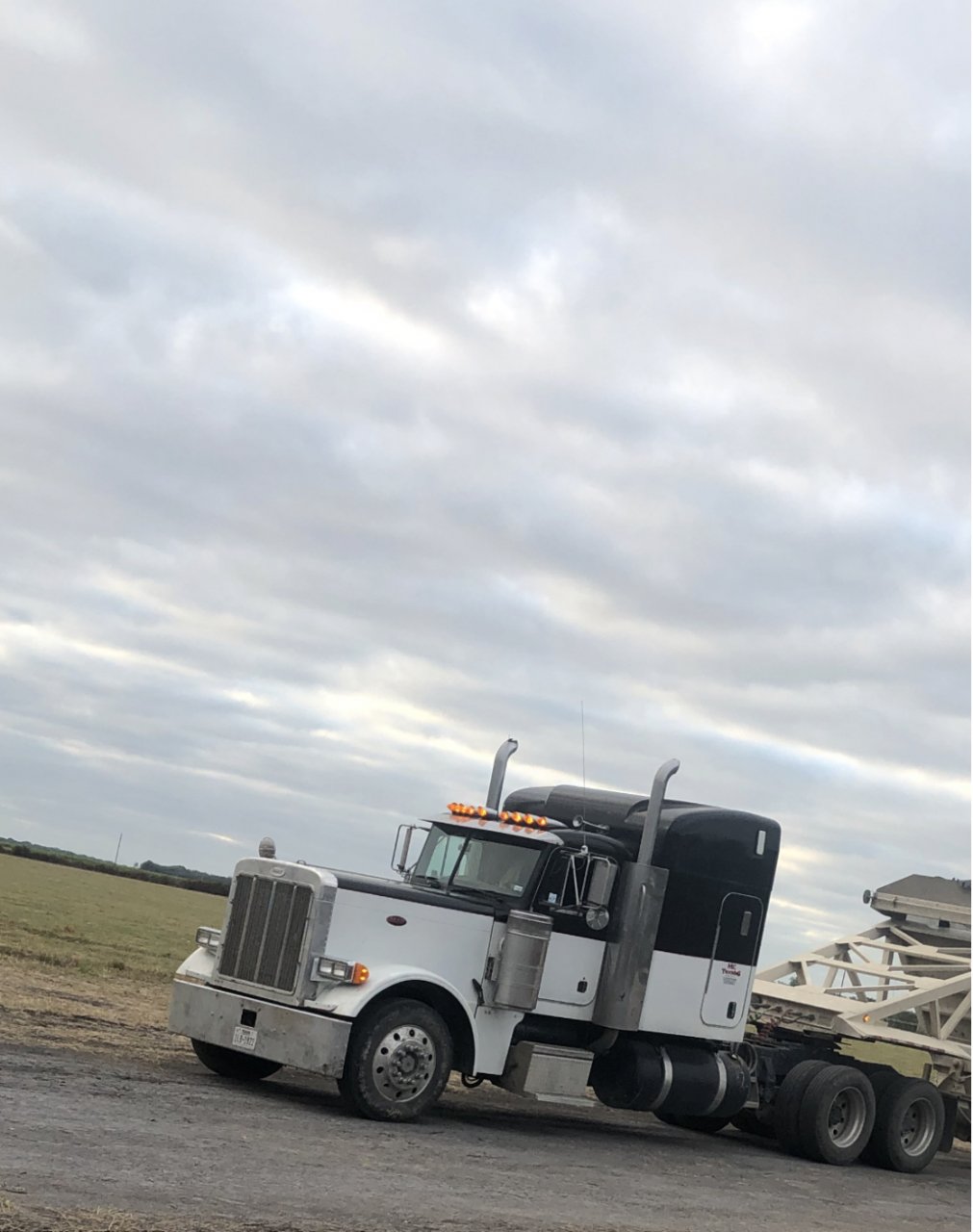

  4. TexasBoy21
    TexasBoy21 Bobtail Member
    16
    2
    Jun 22, 2017
    Is there a reason why my sleeper is real high ? The air pressure is right if I release all the it from the sleeper bags the sleeper levels with the truck
  5. boneebone
    boneebone Road Train Member
    2,294
    2,365
    Mar 13, 2009
    You need to adjust your cab leveling valve.
