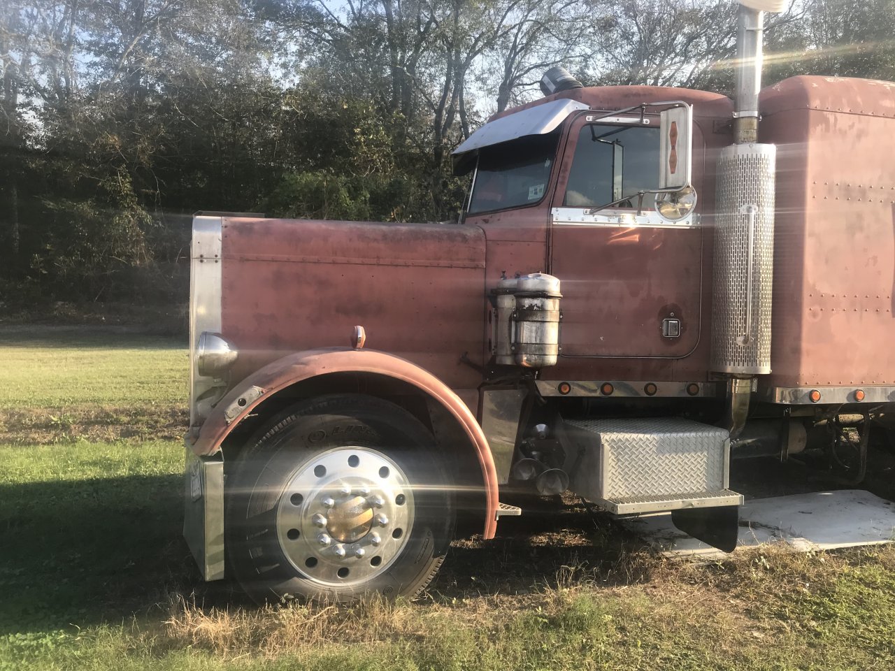

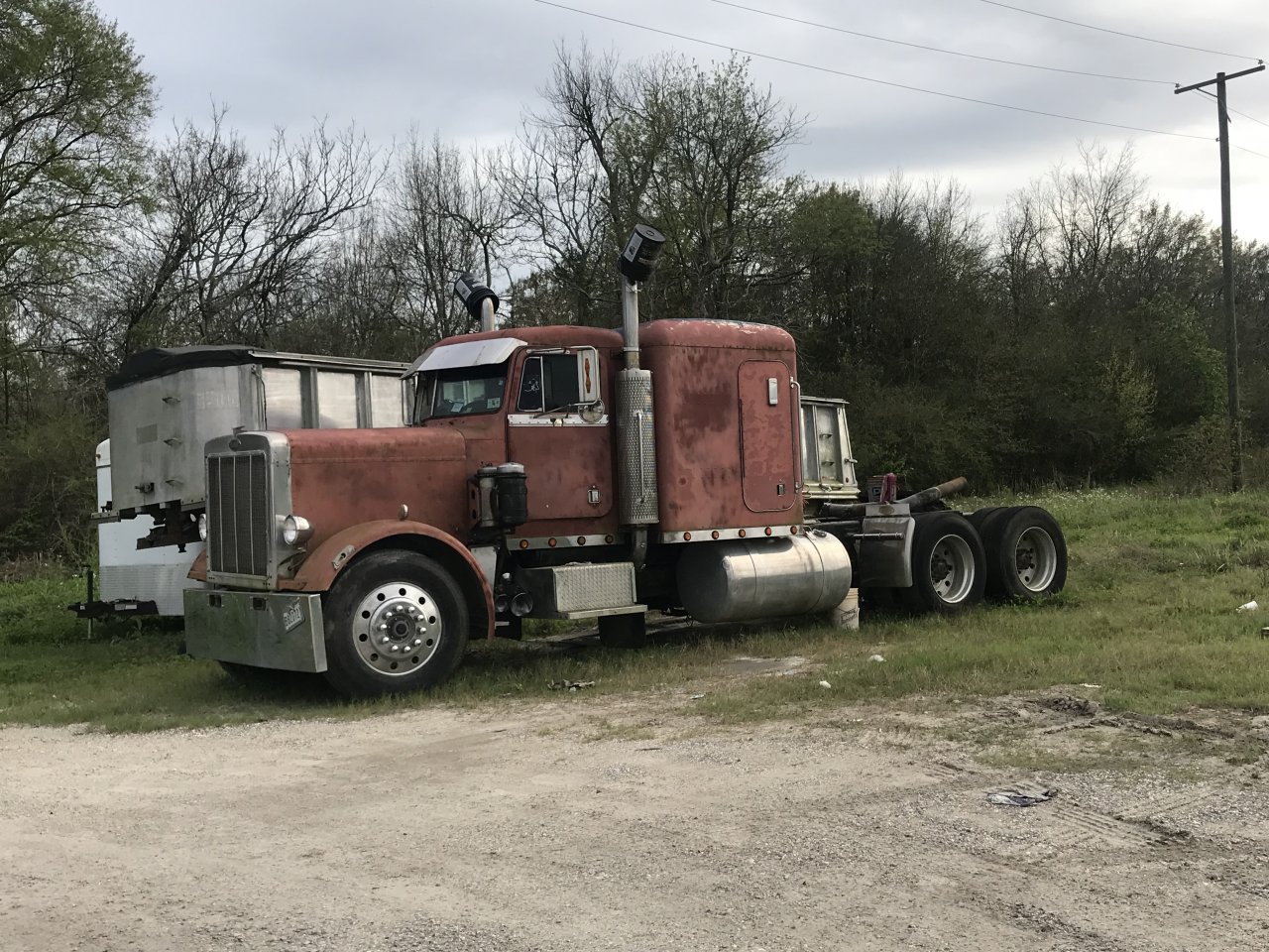

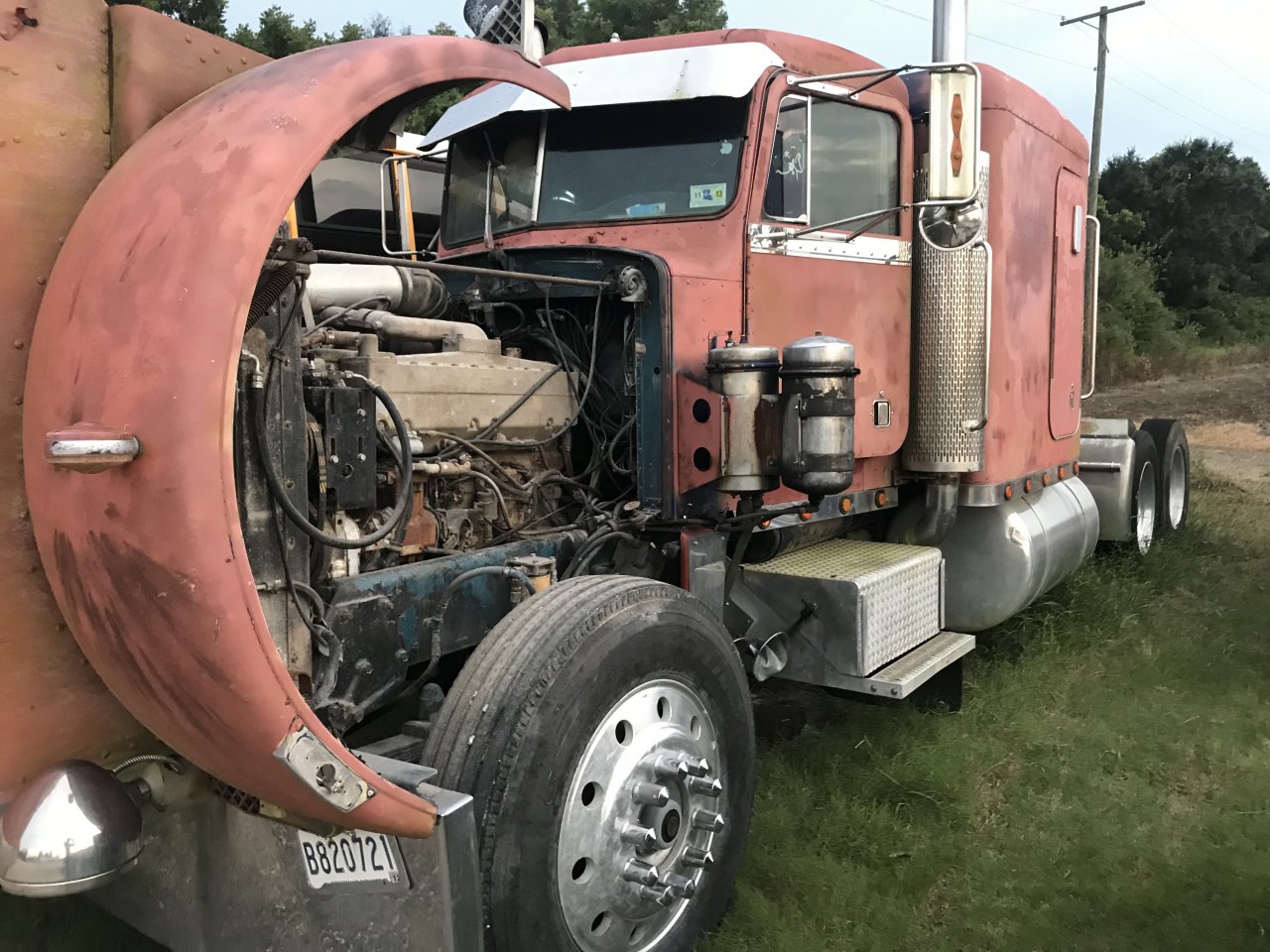

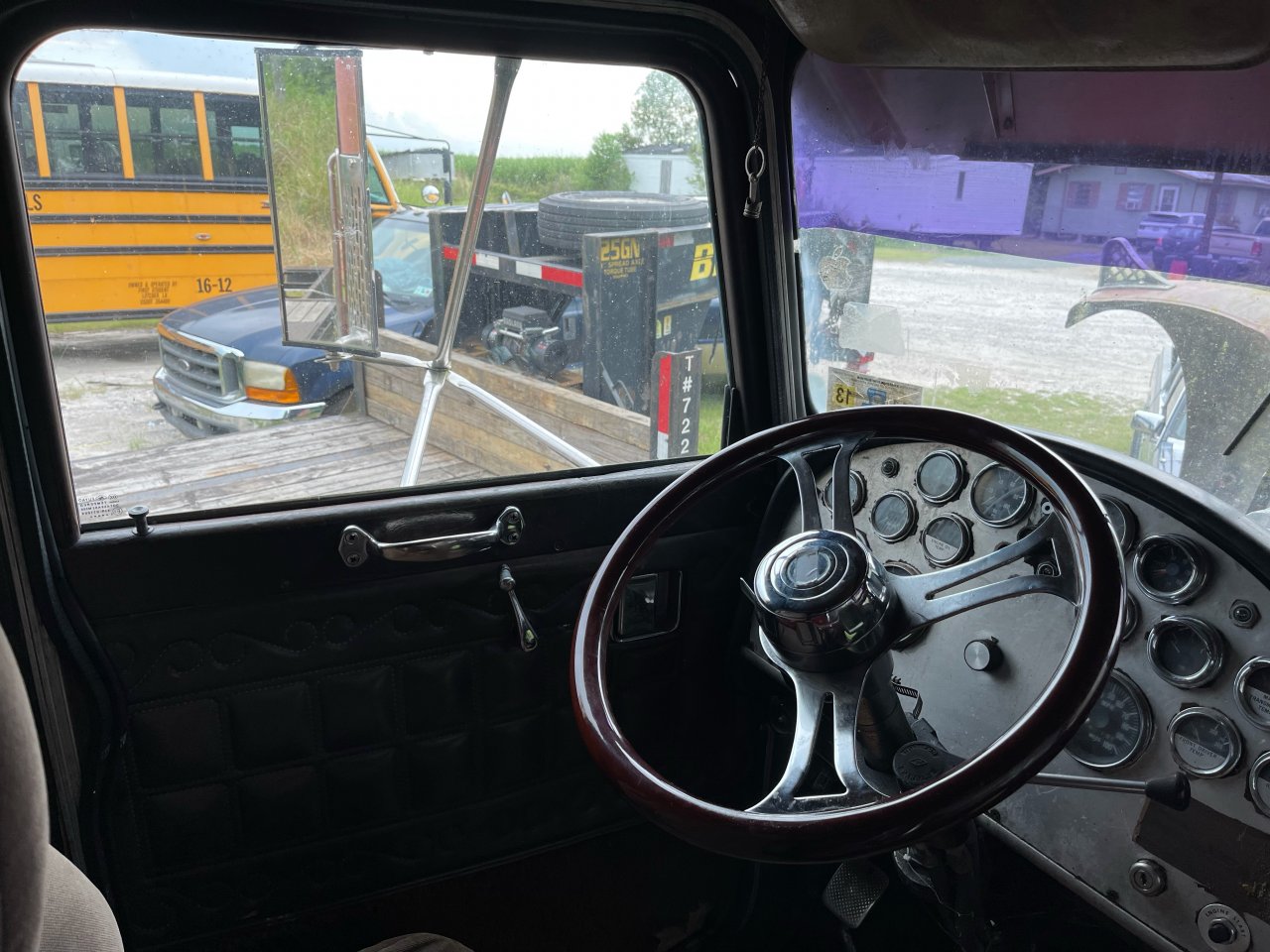

    5AED7CC5-CA8E-4A1D-81FD-EBA82839E71C.jpeg 7D00EADC-4C4F-483C-9A1A-F7D7A285E2DC.jpeg 30F217B6-8534-4411-BF79-214A02B7B412.jpeg 54C55383-D31A-4013-9139-9198C601AB45.jpeg 30F217B6-8534-4411-BF79-214A02B7B412.jpeg

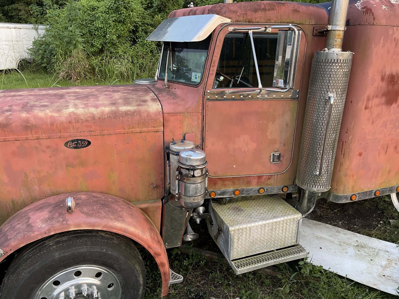

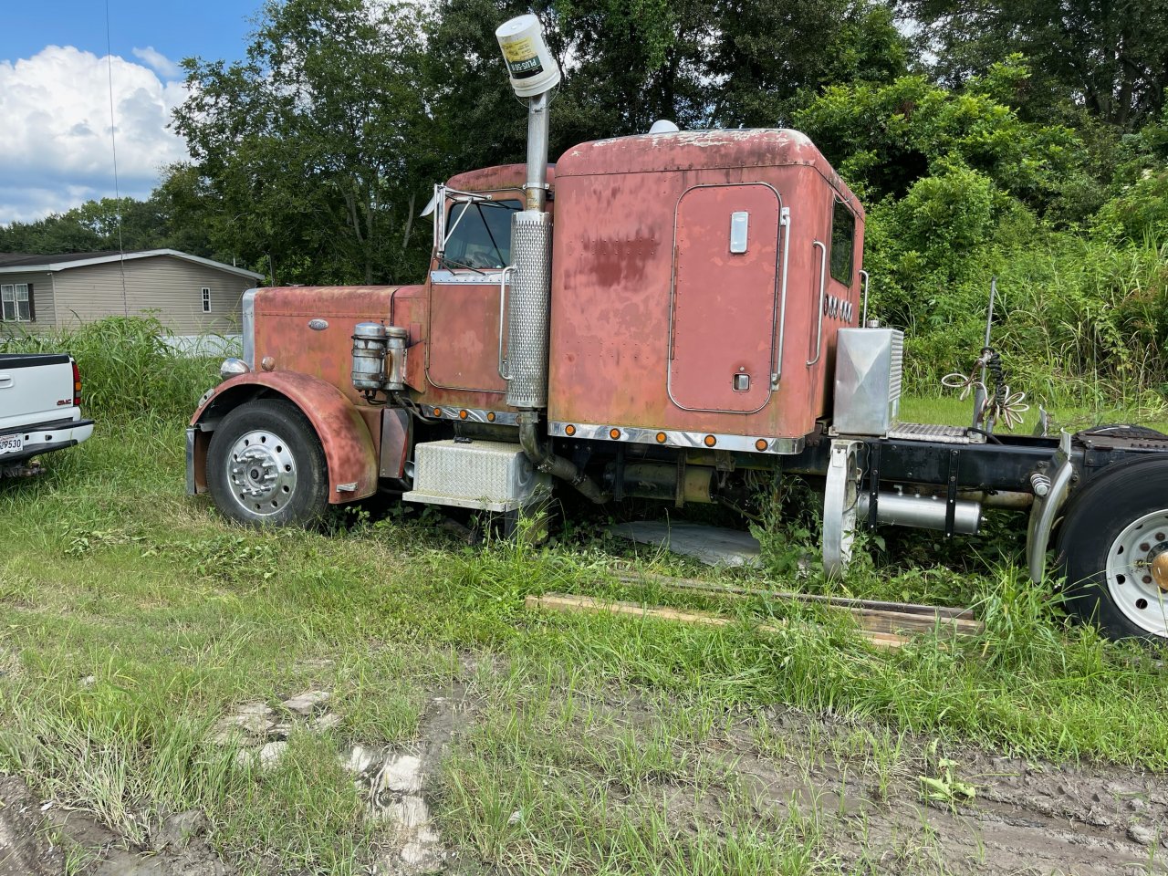

    here’s how mines looked I kept everything manual windows
    ProfessionalNoticer Thanks this.

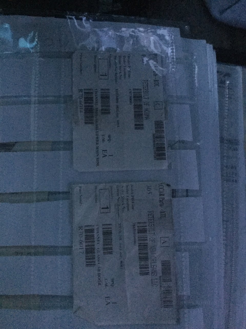

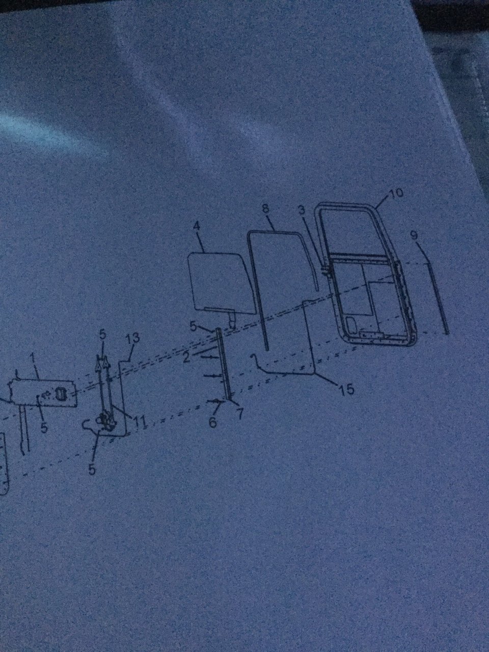

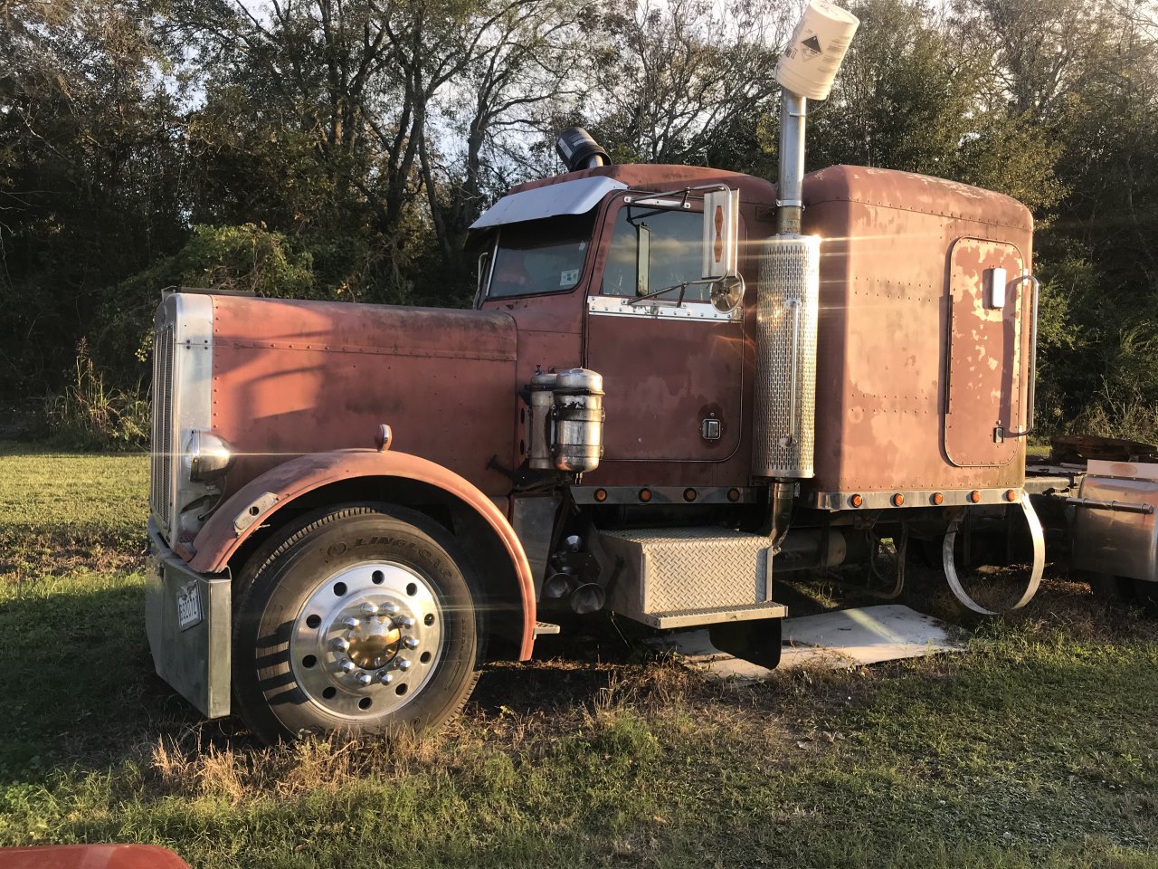

    image.jpg image.jpg I used part number of of the parts used everything bolts right up image.jpg
    zbright85 Thanks this.

    434F843D-5BBA-4E67-A7CF-D6894CECC738.jpeg 1B804D2D-0FA0-4E3A-88F6-38445CCEFAB3.jpeg 6C1EFED4-6A6B-4493-A9FC-BB6E2344A84B.jpeg Here’s some pics

  11. Saban12
    Saban12 Bobtail Member
    1
    Aug 17, 2021
    That looks good for sure I'm doing the same thing on my 2000 379 kind of hard to see the part numbers on the picture did u have to use all the parts on the diagram looks to me the only big problem would be the little corner piece on the bottom is is there a part number just for that
