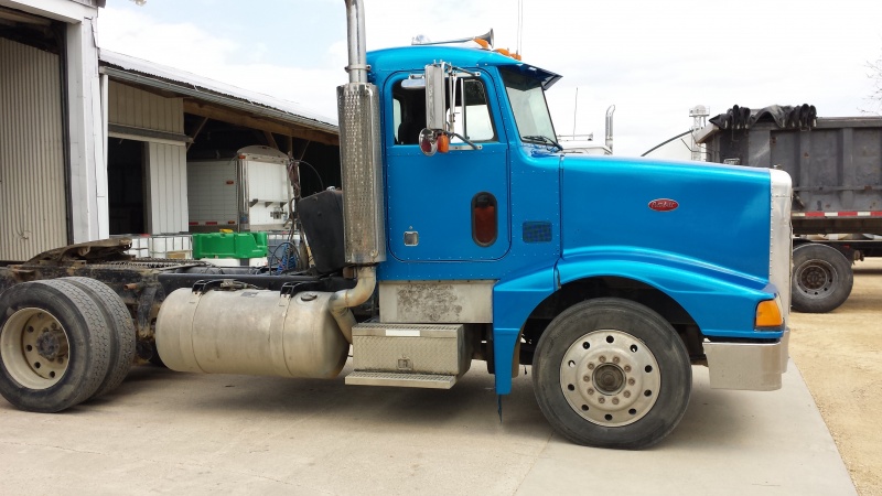

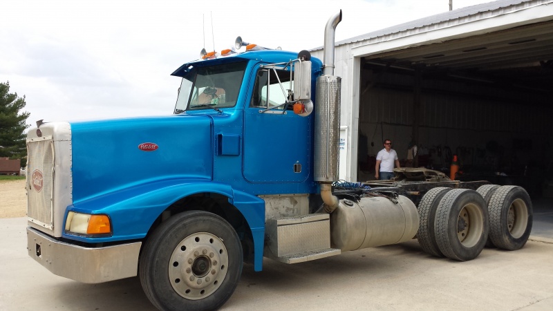

    See if you can tell in attached pics. Truck needs to be polished up don't mind the dusty tanks and wheels.
    The rubber is in tact under hood, the drive side just sits a little high, it doesn't even touch the bump stop on that side. So when driving it flops around a little.
