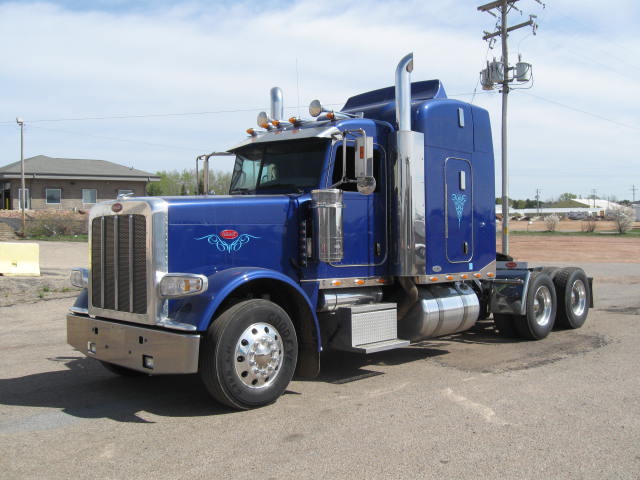

    OH, I thought I would at least post a picture or two...
