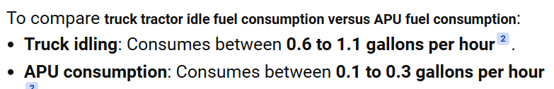

    The Thermo King website has an APU payback calculator.
    APU Payback Calculator
    Truck - Using .8 gph x 120 nights x 10 hours x $4 per gallon of diesel = $3,840 cost to idle
    APU - Using .2 gph x 120 nights x 10 hours x $4 per gallon of diesel = $960
    3840 - 960 = $2,880 per yr savings About 3.8 yrs to recoup 11k
    But with APU there is less wear on the engine and less frequent oil changes in addition to the greater versatility already mentioned. Without an APU the idle hours add up to at least 4,000 hours over 4 yrs and could be as high as almost 6,000 hours.
