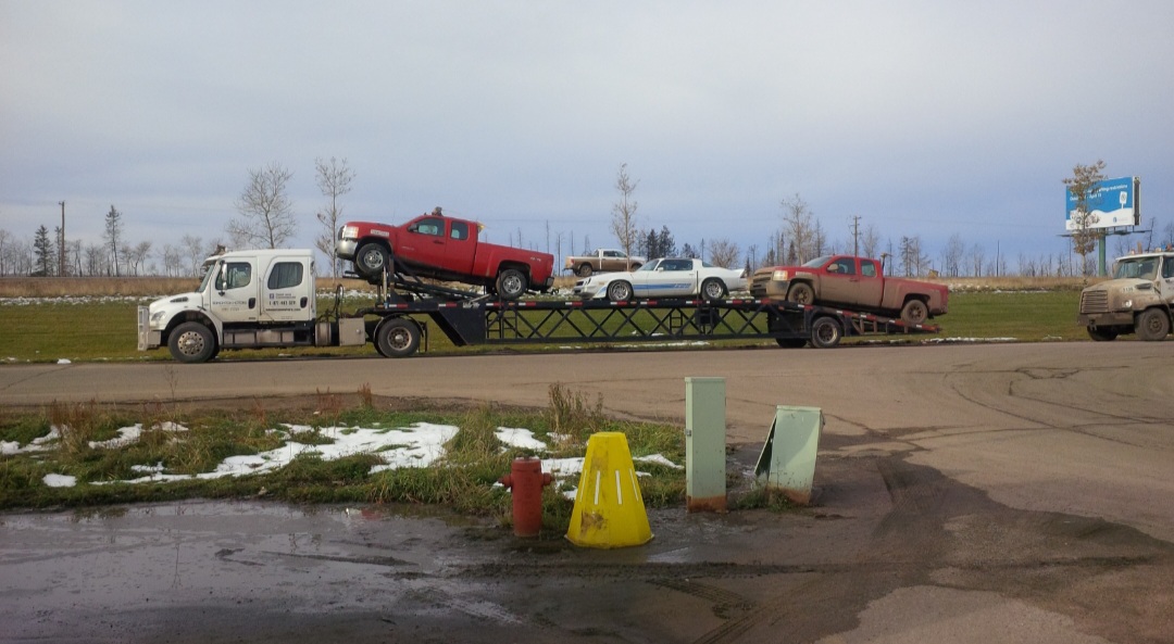

    Still planning a custom built trailer for my truck. I drive in a heavy toll road area.
    For example, NYC - Richmond VA - NYC with a 5 axle vehicle is $380.48. With a 4 axle vehicle its $277.40. I can sometimes run this twice a week. I save $400 - $800 a month running a 4 axle vs 5 axle.
    I'm thinking single 15k axle on a single 24 foot total length car hauler for my truck. I know the hitch weight will be higher with a setup like this but my truck can handle it as its a class 8 tandem straight truck. Axle placement right before 8 foot (?) dovetail.
    Can anyone give me reasons or opinions why this is not a good idea?
    (Thought about singling out my truck also but I think I would need the extra weight capacity on the rear)
    Truck currently registered for 46,000 lbs, scales at 11,700 front (12,500 axle) and 14,060 (34,000 axles) on the drives. I have never scaled when loaded and have loaded upto 11,000 lbs on truck so far, no weight stations have stopped me yet lol.
    Trailer will be overbuilt just like I like it, 17.5" tires capable of over 20,000 lbs, bed will be 96" wide above the wheels for dual tire truck loads and overbuilt chassis. I'm guessing close to 4k curb weight and 9-10k max load. At least 30% weight transfer to hitch is my best guess so maybe 5,000 lb transfer. Lightning up the front axle a little bit would actually be pretty good for me.
    Loading ramps from trailer to truck are the main feature for me. I really don't want to have to disconnect from trailer to load/unload the truck.
    Example of single tandem trailer:

    Gotcha. Nice lookin unit.
