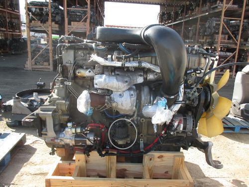

    Hello everybody,
    My father bought an 2012 freightliner cascadia that has 1,000,000 miles. We have found two issues with the truck. The first one is that there seems to be oil in the coolant tank. Second one is that after the engine starts running for like 10 minutes, there is smoke coming out from the part that circled in white in the picture. So my question are:
    1. what is the name of the part in the circle. I think i can find the function of it after doing some research.
    2. what could be the problems for these two issues?
    3. how much is a reasonable price to fix them?

    Oil in the coolant is usually a failed oil cooler. Most engines it isn't a terrible job. Not totally familiar with DD, but looks like a centrifugal crankcase oil separator. You are probably seeing blowby gases, steam from here as it vents to the atmosphere.

    1. I’m not sure what is called, but it the EPA version of a blow by tube. Basicly it’s a centrifuge that throws the oil out of the blow by vapors, puts the oil back to oil pan, and gassed into air.
    2. It’s possible that the “centrifuge/ blow-by filter” isn’t working or is gummed up, but it should throw a under speed code / check engine light. With out looking at it, I couldn’t tell, it maybe time for an in frame, or it could be as simple as replacing the “blow-by filter”. Your oil in the coolant resovoir could be a leaking coolant/ oil filter housing. It might not hurt to have the fuid tested, sometimes Exhaust in coolant can look like a dark oily residue, which would suggest an EGR cooler.

    Thank you guys for the reply! I did some research also, it seems like the oil cooler issue if there is oil in the coolant tank. The problem should likely be either the oil cooler house seal or oil cooler itself. So The price of 500-750 includes labor or not? What is the average labor rate for the mechanics? I am not sure about why EGR cooler would cause oil leak in coolant but i will research on that also.
    About the smoke, I found a very good picture that describe the engine structure, the part circled is called the crankcase breather. According to wiki, if you see smoke, the problem is the piston ring that is broken. If that is the case, it would require to take out the piston. That sounds like a lot of money.

    Thank you for the information. You mentioned that the smoke could be due to the blow-by filter, how does a bad filter can cause constant white smoke/gas from the the crankcase breather, could you explain further?

    The blow-by filter is the centrifugal crank-case oil seperator as mentioned by Heavyd. I just couldn’t think of the name of it at the time.

    The crank case oil separator spins at 1000 to 10,000 RPM to knock the oils (and possibly other fluids/solids/vapors out of the air escaping the crank case. Making it as clean as possible.
    They say if you see any oil on it or coming out of it, it isn’t working. There is a speed sensor mounted in the top. If it isn’t spinning (not working) the engine computer will throw a code and should kick on the check engine light. Which the code that you show active doesn’t confirm that.
    I’ve been around many DD15’s but none much over 500,000 miles. At the beginning of this thread I could see a scenario where this breather wasn’t spinning fast enough, not working, and/or not cleaning the gasses escaping while the engine was warming up. It’s still a possibility, and this breather is simple and easy to replace ( if you can get to it) and maybe something that would be of a “low enough cost” to try to replace yourself before sending it into a shop for a rebuild/overhaul and is a part that will probably be suggested to be replaced by the shop that does the Overhaul.
    It maybe a long shot, but it’s possible.

    I see how it works now, thank you! But the smoke/gas only comes out from the engine during the engine warming up process, and the color is white. It is possible but less likely due to a faulty crankcase oil separator.
    I think i'd better do a compression test on the engine since it does not cost that much and can gave me more information before i decide whether i should do an inframe.
