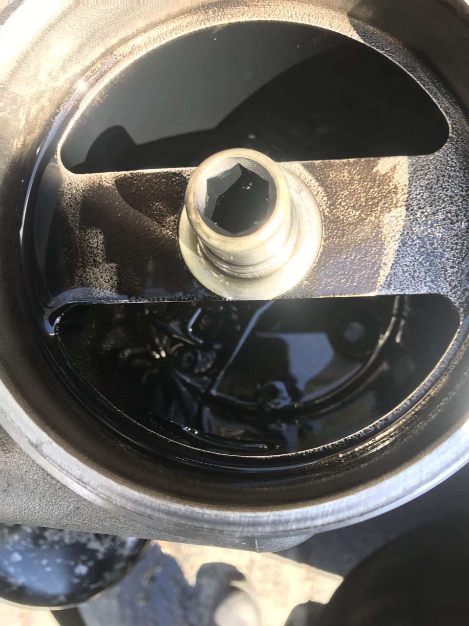

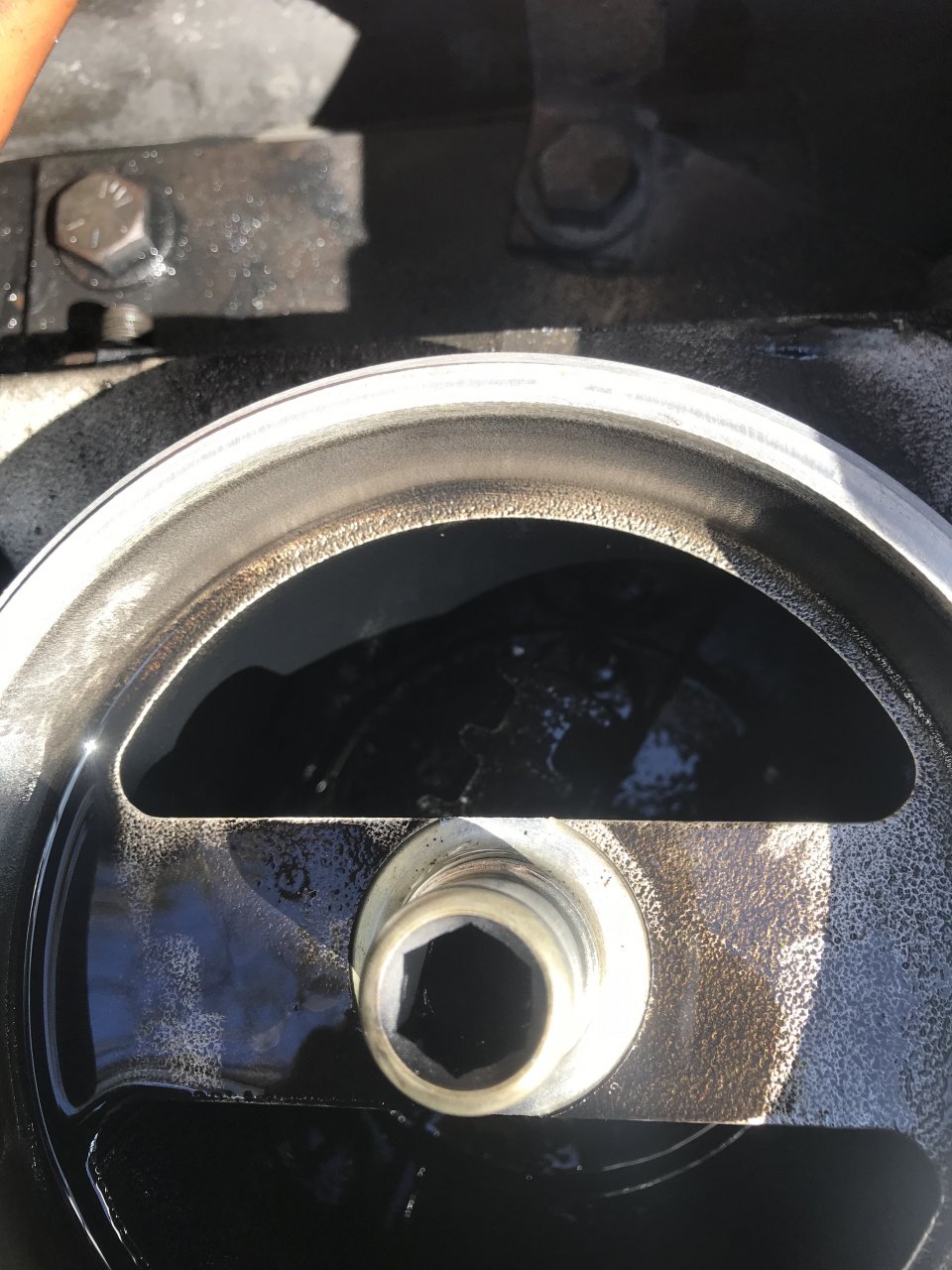

    Hello everyone, my truck has a little bit of trouble starting in the mornings and sometimes when I’m driving and press on the accelerator I feel like it’s not doing much until I shift to the next gear and will do the same thing again. This morning I changed the fuel filter and it was really dirty, I noticed it was full of oil and the oil or black stuff was everywhere.How can I fix this? What could this possibly be? I added a couple pics of what it looks like. Thanks

    Algae. If you look inside of your fuel tanks, you will see it laying on the bottom. There are several products that will help clean it up, but you will be changing filters often. Th best way iIfound to clean the tanks up, is to drain and remove the tanks. Clean the insides out with a HEATED pressure washer. This is how I got mine clean. After that, keep up with the additives to prevent reoccurrence.

    One reason for algae is the reduction of sulphur. Another contributor is biodiesel. Biodiesel is made up of non-petroleum products. When biodiesel gets heated in the engine and sent back to the tank through the return line, it warms up all of fuel in the tank. Summer sun heats it up faster. Give it a chance to grow and it will. The longer biodiesel sits, the more it grows.
    ClubberLang, I do not know what fuel your fire trucks are using, but I would guess you have been fortunate enough to not have used biodiesel.
    I bought a Peterbilt that was not ran for about to years and that's how I started to deal with it. When I took the filters off and dumped them out, it oozed out in a glob. The engine would starve out and quit running. The pick up tube in the tanks had been plugged up with algae, so I removed the suction line at the filter base and blew compressed air into it and it cleared it.

    That explains a lot , I’ve been using biodiesel , guess it’s time to stop. What additives did you use?
