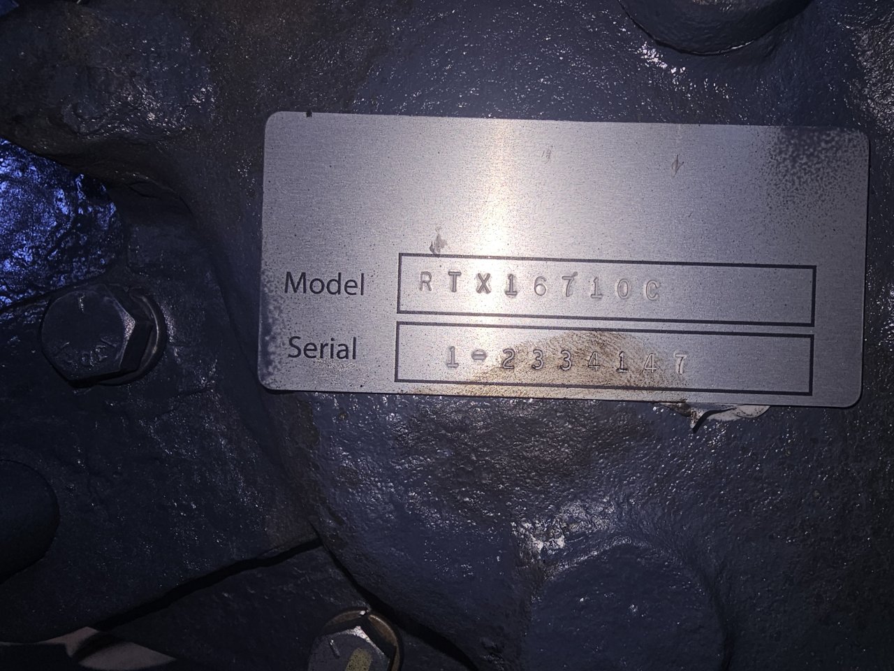

    Got a new eaton 10 speed and on pass side where old one was it had in and out for cooler lines. This one only has 1 hole that says out/ Where is or where do i put the in line?

    What model# is that? Looks odd. Possibly a return up top?

    I honestly don't know. Any other pipe plugs in it? Up top? Does it have the HALO?

    Pretty sure the cooler line ports “In and out” are under the 5 bolt plate/cover. The cover allows oil flow thru the trans when a cooler is not installed.
    The pipe plug bottom left of out is just open to the case and is common to see trans temp sensor.
