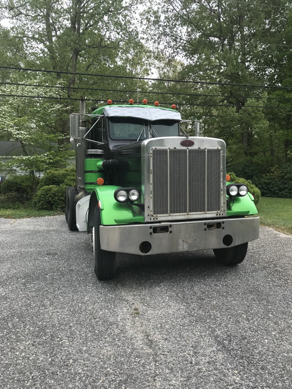

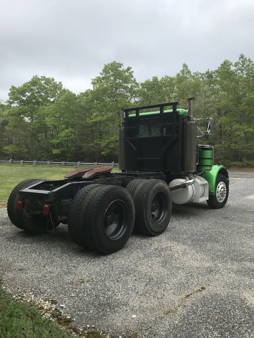

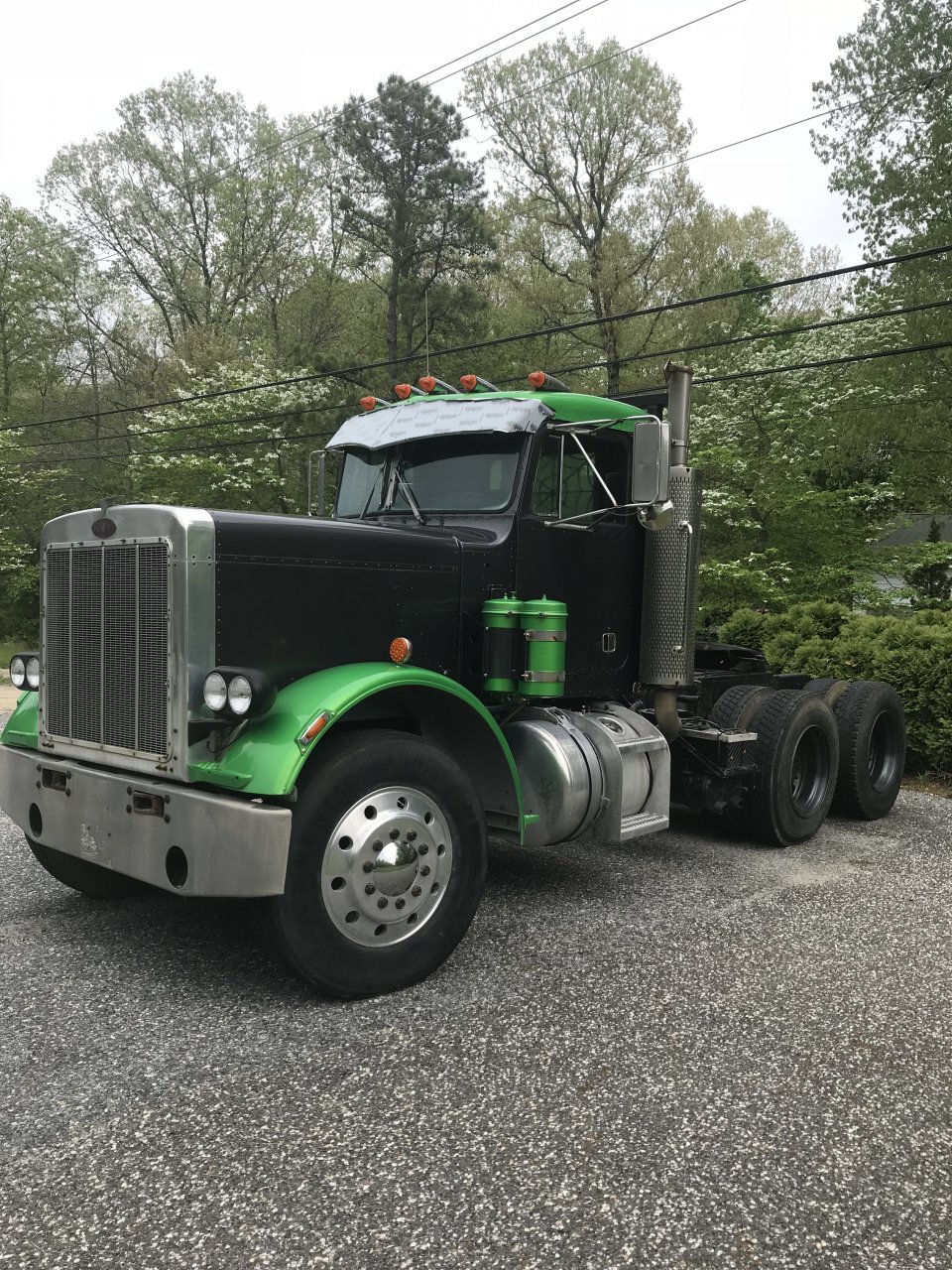

    Only a couple on my phone....
    C5D561CB-16AE-4FE1-BB3E-1D34056ED823.jpeg EB6A5F1F-B373-4E3A-90FC-A0590834A8DD.jpeg 17B8935F-C7DB-4CC7-BD57-0F6DA962C5A7.jpeg
