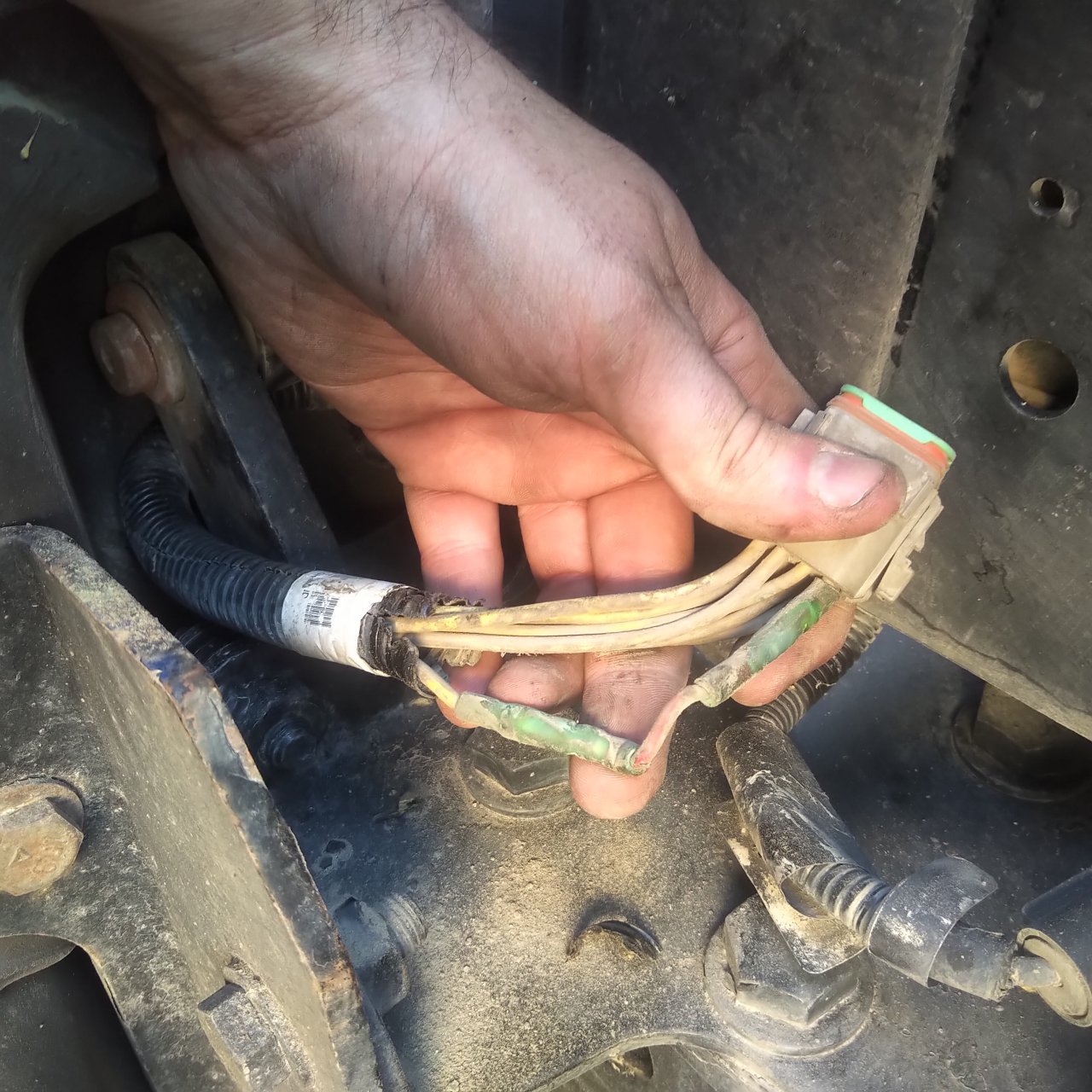

    Update . I plugged in drivers side headlight assembly connector to passanger side harness and marker lights work. So i started unwinding the 500 miles of electrical tape at the harness and we have uncovered a hack repair job.... The 2 butt connectors that is the marker light wire..
  9. D.Tibbitt
    20,924
    140,944
    Update we have power to the marker lights just under the bottom butt connector... thanks for the help fellers

    Find a junker truck you can take that plug from for $10... Take about 12" of all the wires with it. Then do a proper soldered slice and heat shrink on the whole deal.
  11. AModelCat
    28,855
    154,364
    If I were to repair that, I would simply unpin that wire from the plug, crimp a new pin onto a length of new wire and solder it in to the main harness. Only 1 splice in 1 wire and you'll probably never have another issue with it.
    That plug looks like a Deutsch DT series plug. Should be able to get the female socket pins at just about any auto parts or industrial supply store. Budget crimp tool is pretty cheap. Just have to pull the green part out, pop the lock tang back with a small screwdriver and pull the wire out the back. New wire would just push in from the back until it clicks, then put the green plastic piece back in.
