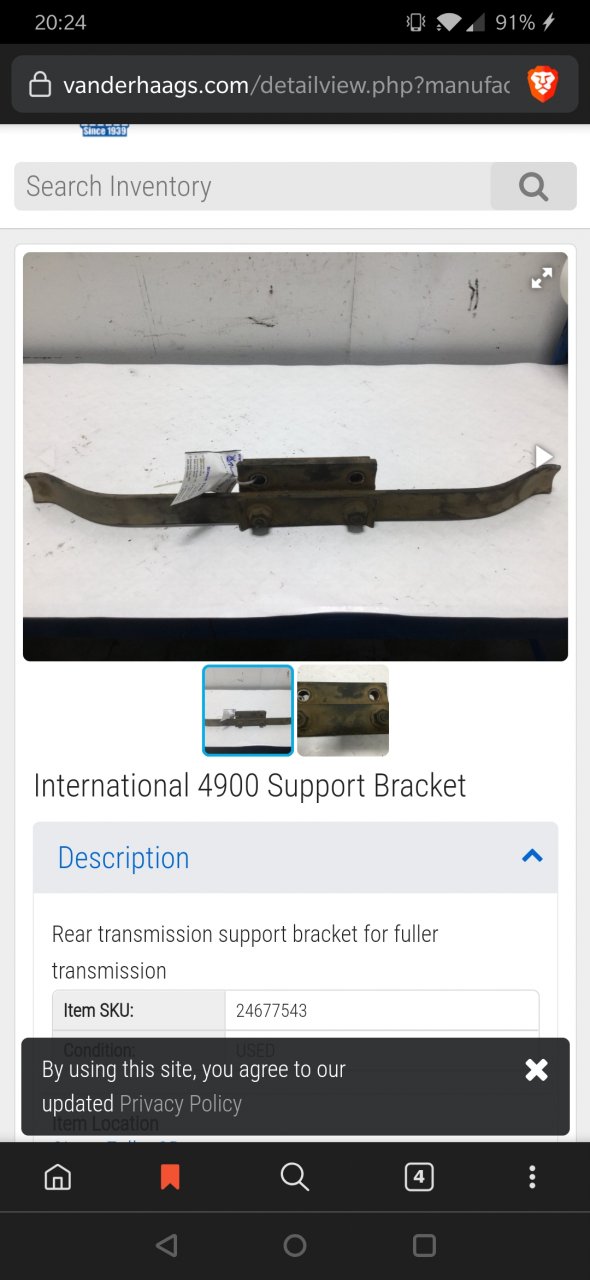

    Mine mounts different than the powerstroke.
    I still use the 3 point that the inlines do and the sae2 bellhousing. I'm using the 8ll rear crossmember mount which is the same as the RTLOs. The most I may have to do is build a custom bracket for the crossmember. Since I only ever saw the 8ll's on the dt466s which set about six or seven inches more back. So the correct mounting holes in the frame may not be there for the t444e.
    The engine bellhousing adapter on the Allison automatics are different than my current one, the automatics use sae-3 as I remember right. Plus a good deal of those automatics won't handle my eventual end goal. Stock transmission atleast.
    And I can find sae2 RTLOs. I also have the correctly sized fly wheel. As I do believe Volvo uses SAE2. Besides the company that I'm going to end up buying the transmission from said they will locate an SAE 2 BellHousing for me even if the current transmission I'm buying doesn't have it.
    But thanks for the information on the automatic eatons I'll start searching to see if I can somehow get it to control the throttle as well.
    Here's a photo of the rear bellhousing mount. This is an older photo of when I was doing my up pipes.
