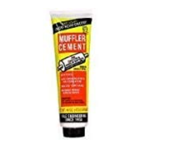

    Advanced auto parts or most automotive parts stores have muffler cement it dries in heat and does quickly
    Trcknwolf Thanks this.
