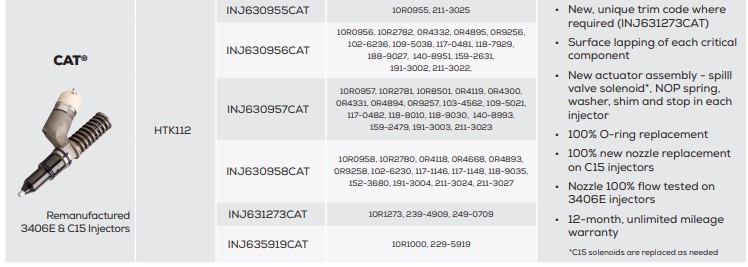

    Thanks everyone for all the responses, I've been looking at new cams and have it narrowed down to a few different ones that all say they are similar or the same as my 136-1175 stock cam other than a few 550hp stock options I've posted below
    So I can get a stock 136-1157 for around $1250 plus shipping from Pittsburgh power or a new HHP for $850 or so.
    HHP new cam 0R7653 for about $900 + shipping
    PAI 391908 for about $1000
    Raneys PAI 1879381 for $1200 shipped
    I've seen the 1390538 camshaft listed a few times in the forums as the cam in the 550 hp stock 3406.
    I guess basically they are all similar enough in price that if there is one that is better, I'd like to know. Also, HHP has all these new for around $850-$950 shipped. Just wondering if it's worth the extra going with the name brand camshafts.
    I'll post a screenshot showing all of these cam part numbers plus a few more and maybe there's something there that is better that I haven't mentioned.
    Thanks again for all the advice!!

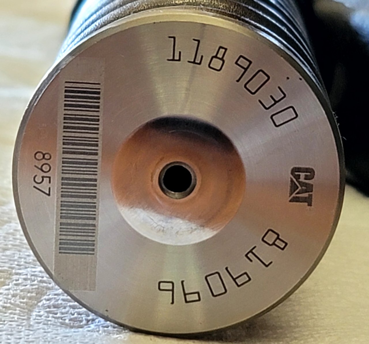

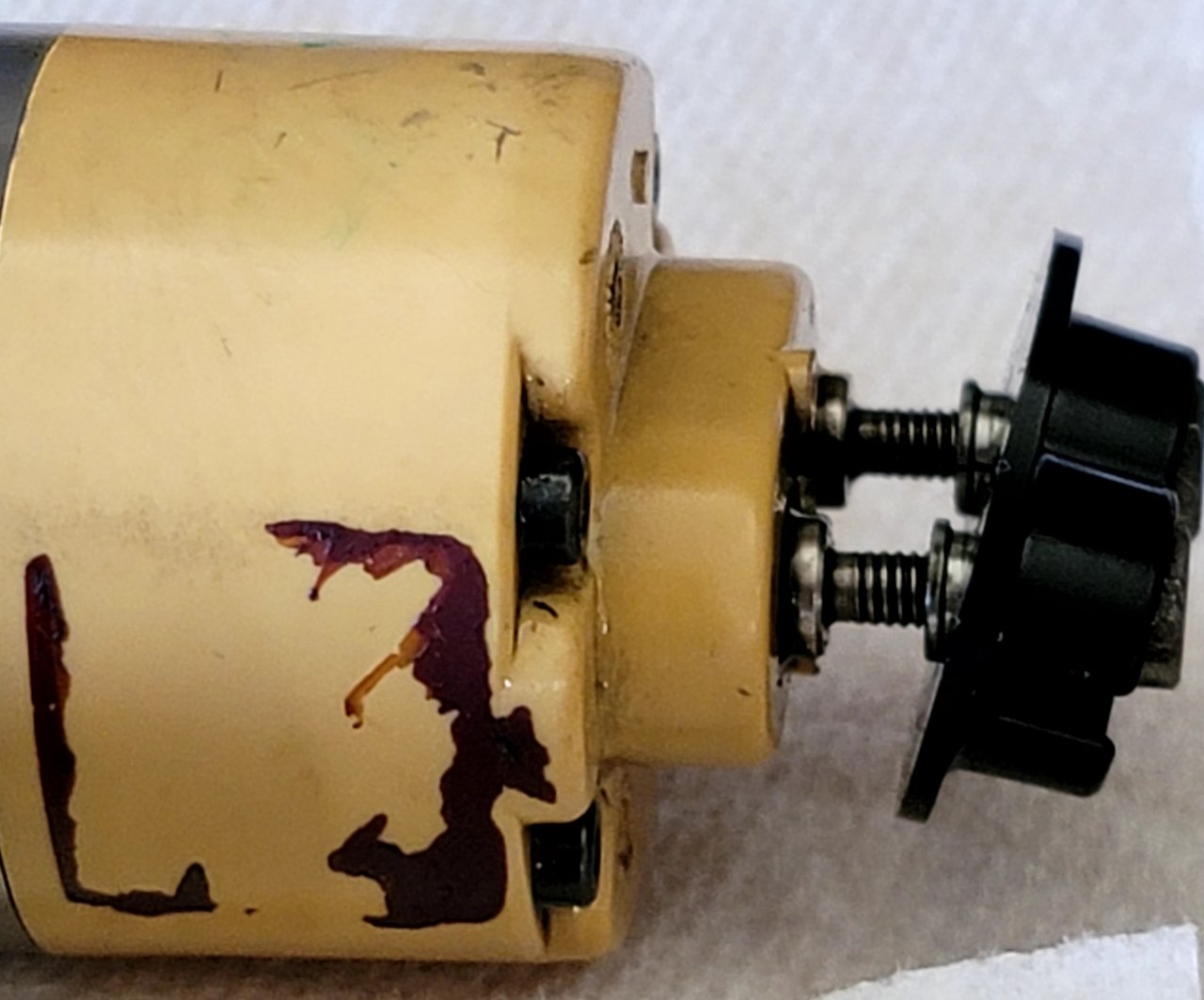

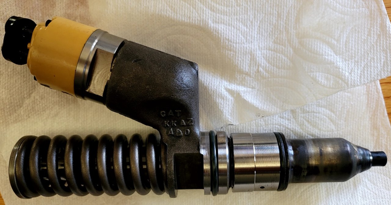

    I decided to pull the injectors to see what I have as well. Looks like I've got some different part numbers but they match up as far as I can tell. I'm not sure if they are 57's but it appears that they are based on the information I've found. Also they are missing the file number off the sides, so I was wondering if there is a way to make sure that the right file number is programmed into the ecm. The numbers on the top of the springs are 1189030 and the other one I pulled so far is a 0R4894.

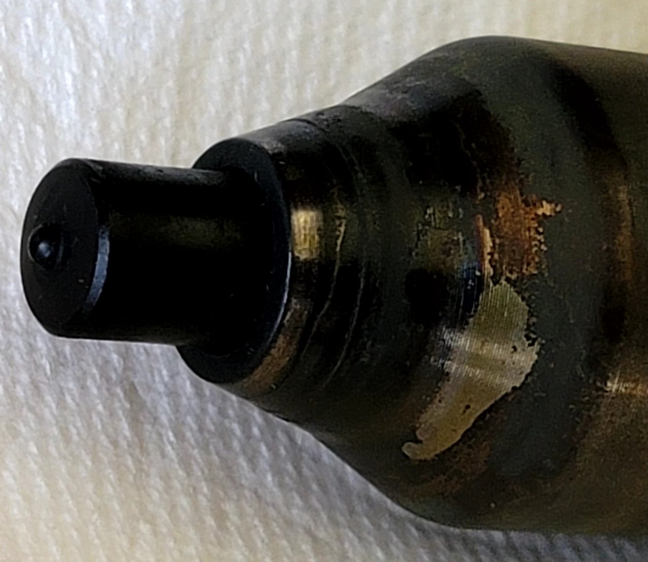

    Here's the 1189030 injector. Any Ideas for cleaning the injector tip/nozzle before re-installing? I already have new o rings coming this week.
