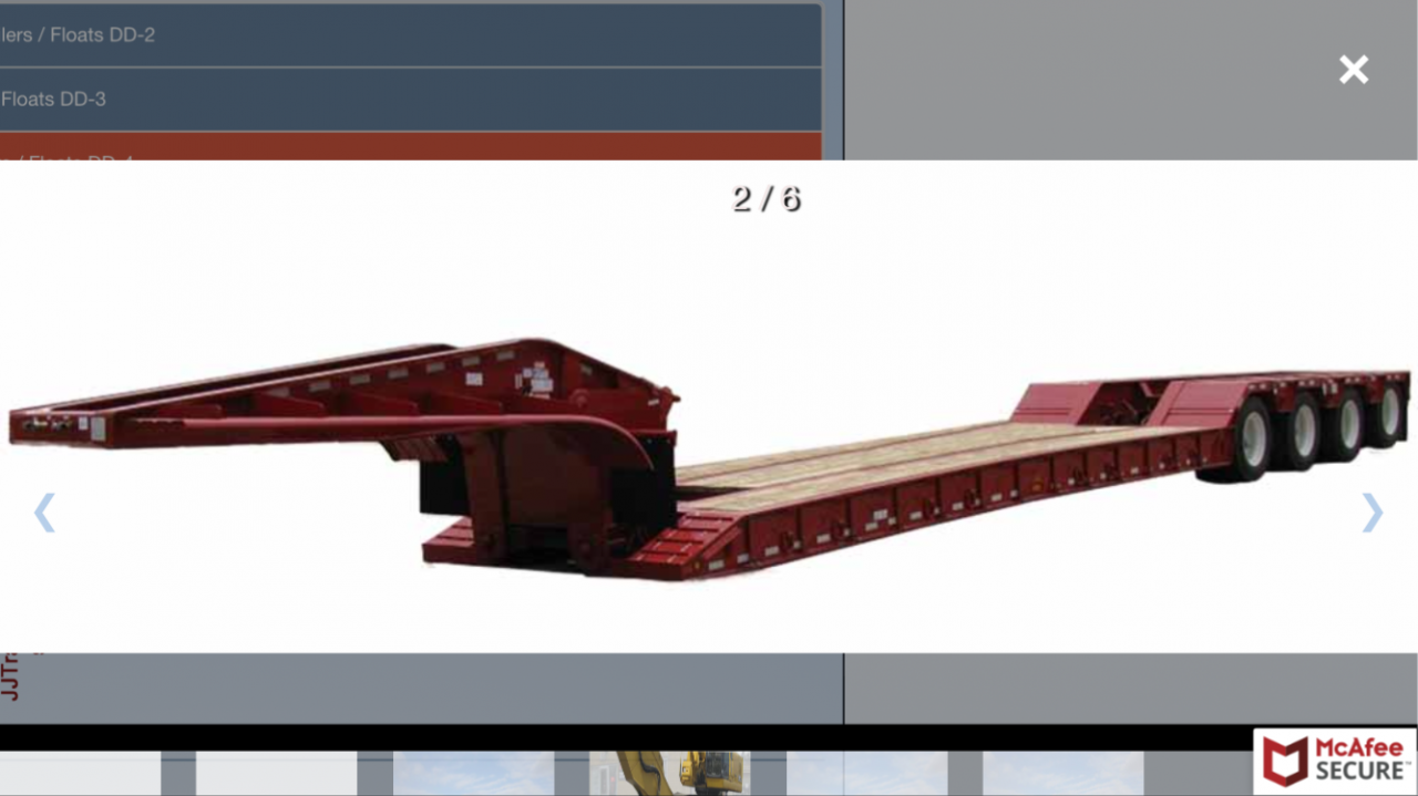

    If I were in your shoes, I'd buy a 50-ton RGN, with a third lift axle, 24 to 26 ft. well and covered rear wheels. That's what most contractors use in my area. But we're complying with US and North Carolina weight laws, and I'd rather have too much trailer than not enough. I wouldn't own another trailer without a covered rear deck; it's just too useful.
    I've had three Eager Beavers and I've found them to be good "contractor grade" trailers. They're not the lightest or the fanciest, but they're reasonably priced and the factory parts support is excellent.

    J+J Trailers/Scarborough
    DD3-50 ton
    options: 3rd axle lift
    covered axles
    manual #1 axle lift
    over-ride chains
    I have not personally pulled one but worked beside one and I think that this trailer would work well for you and has the added advantage of being almost local.

    Hello, I appreciate the info. I never even though about these guys and the funny thing is Bridgeland road is around the corner from my transfer station. I agree with the 3rd lift axle as we can run a 2 axle setup when empty and leave the last axle up. The covered axles was something I was suggesting to my upper management as it can increase what we can use it for, as it becomes a usable space and we don't need a trough for bucket arms.
    What would be the point in the manual #1 axle lift though, and the override chains?
    We want to keep the trailer as simple as possible for operation purposes.
    I appreciate the link, with that I was able to discover head office is around the corner from me.

    The override chain will stop ripped air bags when loading /moving in uneven ground where a wheel can drop into a hole and be unsupported as the unit adds air to carry the weight on the other axles.this This has happened to me.
    The manual front axle lift is to add weight to the drives in uneven/wet ground while cutting down on side axle torque maneuvering tight corners.
    Neither one is necessary but both have advantages for your operation. They are both things that I had added to my trailer after doing similar work some years ago.
    The bucket trough can be covered with a flip-over plate until needed later if you move an excavator for a different division of the city and J+J won't have to engineer a different rear structure.
