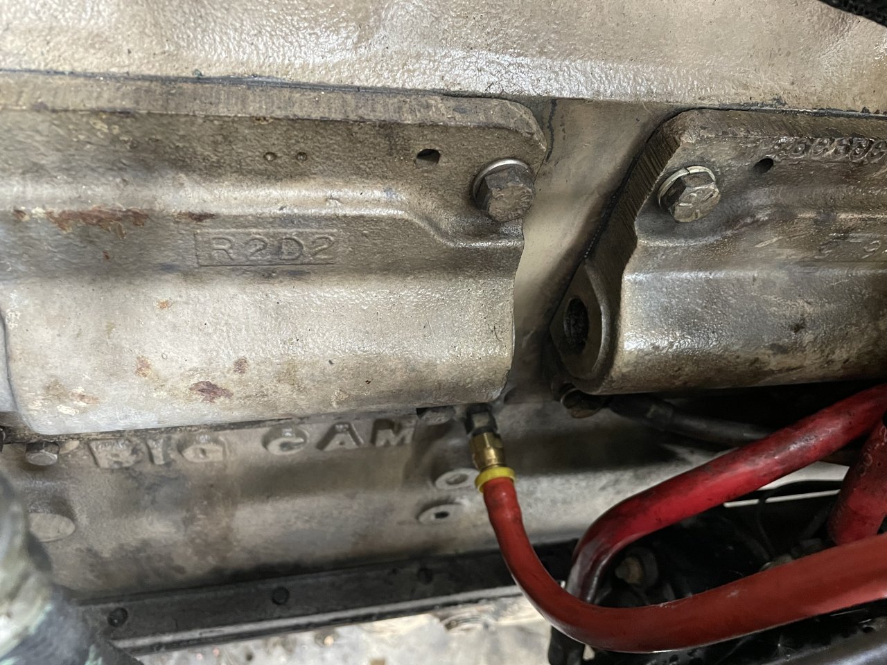

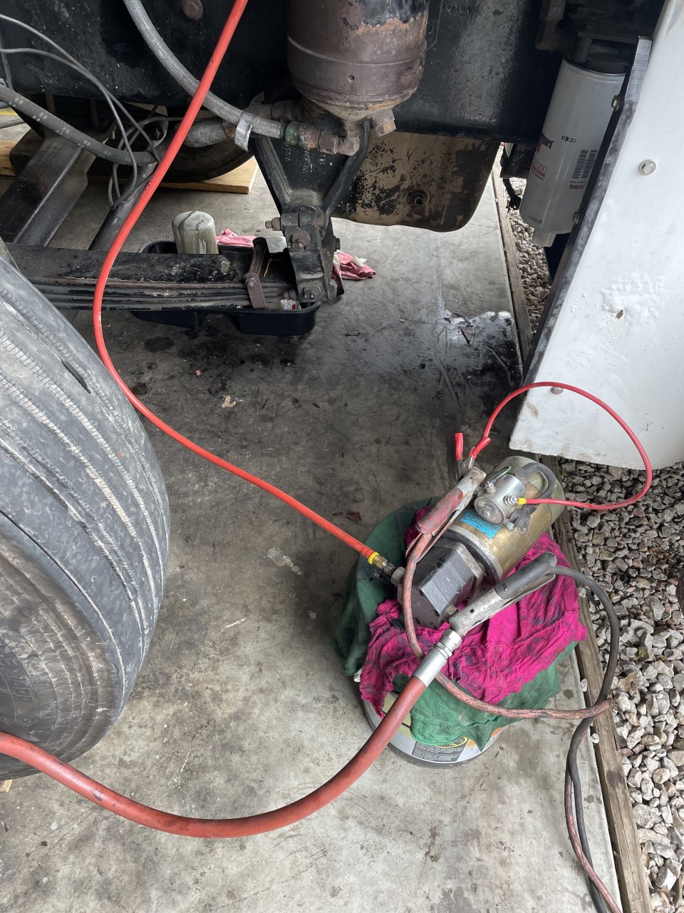

I have a small pump I hook into the oil galley right above the starter, pump a few gallons of oil in it and it should pick up fine when the engine starts….

Thank you. Not a significant amount. Can I add oil through the temp sensor port?
I’ve got my old pump took apart and I’ll examine it to see if oil supplied through that port will soak the gears. I don’t have the transfer tube from the pan to pump, on yet so I might be able to put a plastic plug in the sump inlet, before I apply more oil to it.
