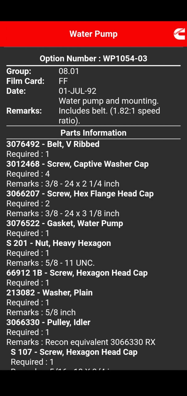

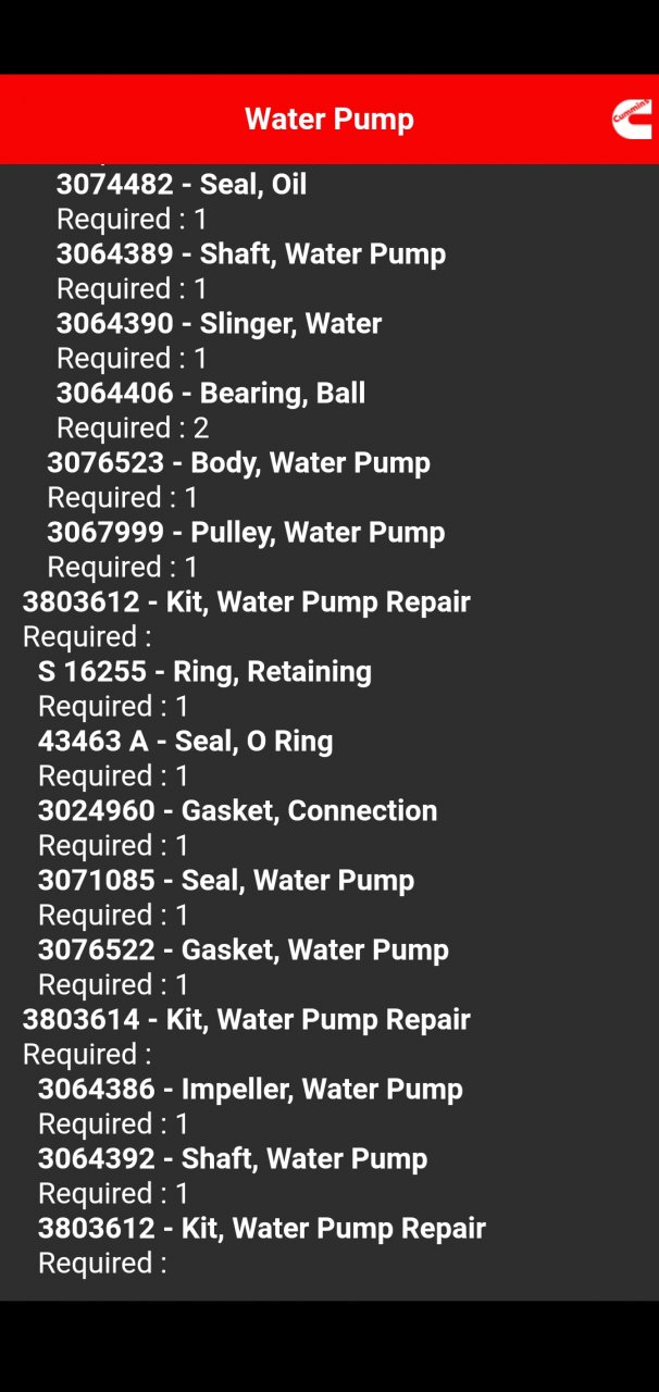

    Screenshot_20210810-190025_QuickServeMobile.jpg Screenshot_20210810-190035_QuickServeMobile.jpg
    Download the cummins quick service app can find out more about your engine that way
