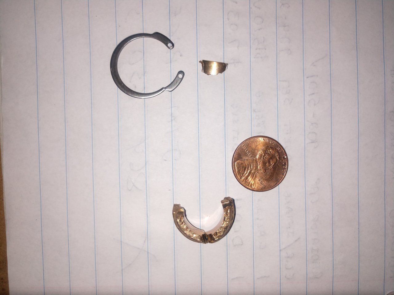

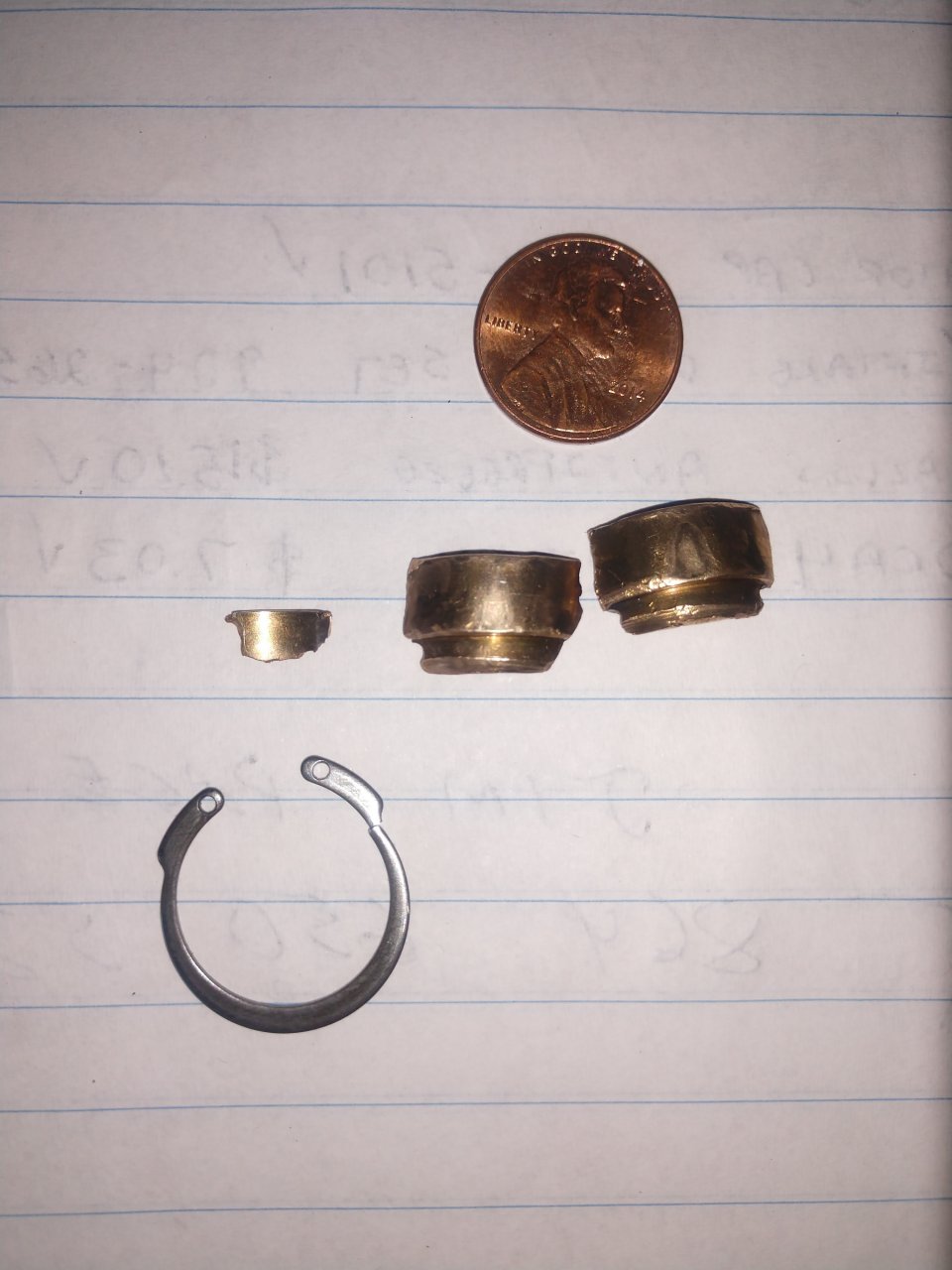

    Mack E7? 2004 CX613 ser 023140. We find no place for them in the crankcase or under the valve cover. Does any one know where these came from. IMG_20190925_111708312.jpg IMG_20190925_111743010.jpg

    the piece of paper, came from a pad, that came from a tree.
    the penny came from the U.S. Mint.
    the locking snap ring may be from a wrist pin..???
    can't say about the brass pieces..

    Its an external snap ring so doubt its from a wrist pin. What about from a rocker shaft? Brass looks like a bushing, looks to be similar in diameter as the snap ring. Maybe a bushing from the rocker shaft?

    Way to small in both cases.
    Did just replace the fuel supply pump. Was leaking oil inthe crankcase. Bushing is to large for that shaft as well as the centrimax filter.
    Engine does not have jakes.

    U have a puzzle, my friend.
    Get out the Vernier calipers, and measure ID of the external Snap ring.
    Also draw the guesstimated diameter the radius of the brass pieces give you.
    Between the oil pan and top of your motor there is a lot of real estate,
    but narrow it down with Dimensions U come up with from measurements, and type of Matl.

    Valve keepers and a snap ring from a rocker perhaps?
