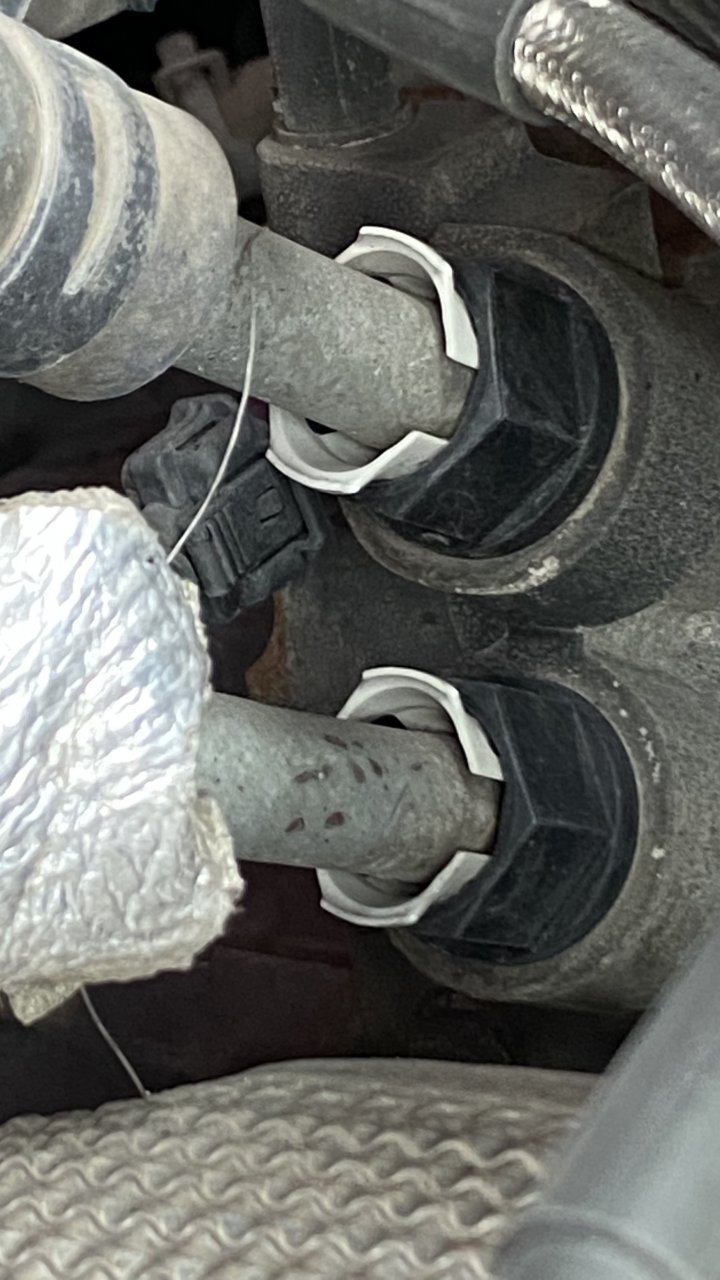

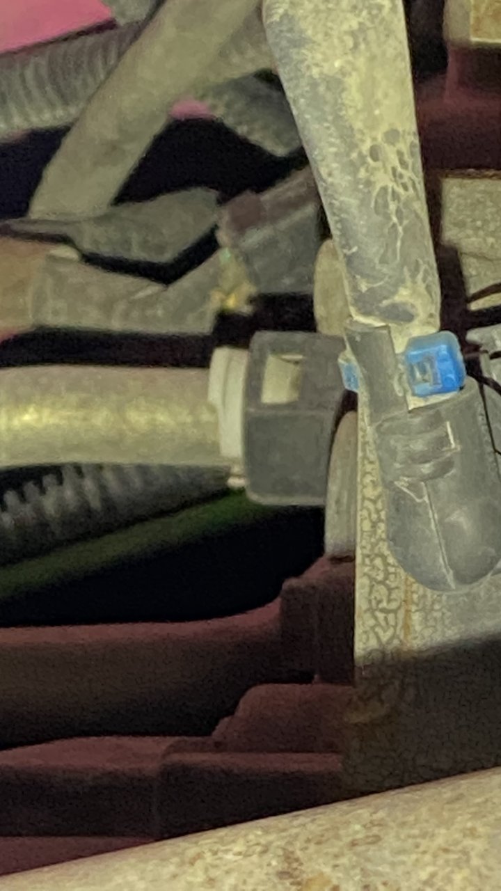

    106C83CD-4EAA-4C1A-87D3-B6B3CC24003A.jpeg CF9F5F5D-40BB-4F21-95B5-75F0B9206211.jpeg It looks like 3 plastic fittings on my MX13 need to be replaced with brass ones. 2 are behind the turbo and it only looks like 1 on the back of the motor.
    Do any of you have tips for replacing these. I heard they'll probably break when I try to get them out.
    Can I reach the one behind the head if I take off the filter assembly?
    Thank you

    They can break off which you will have to extract the broken threads. I have a couple small guys that can reach behind with the air cleaner off. Its blind and by feel and very tight.
    Only other choice really is to pull the shifter cover.

    Can 100% confirm, had the one on the back of my block break off at the block and dump my coolant. Also had both on the side of the block break and dump all my coolant a few days before that....before you ask i didnt know about the one on the back till it broke.
    As to getting them replaced also ensure you check for the and i kid you not....PAPER gaskets, it tends to leave bits behind that do really really bad things to your coolant system.

    Internal pipe wrench works swell if they do twist off. These can be had at any hardware or home depot. The plastic threads turn out pretty easy after the hex and the oring break off.
