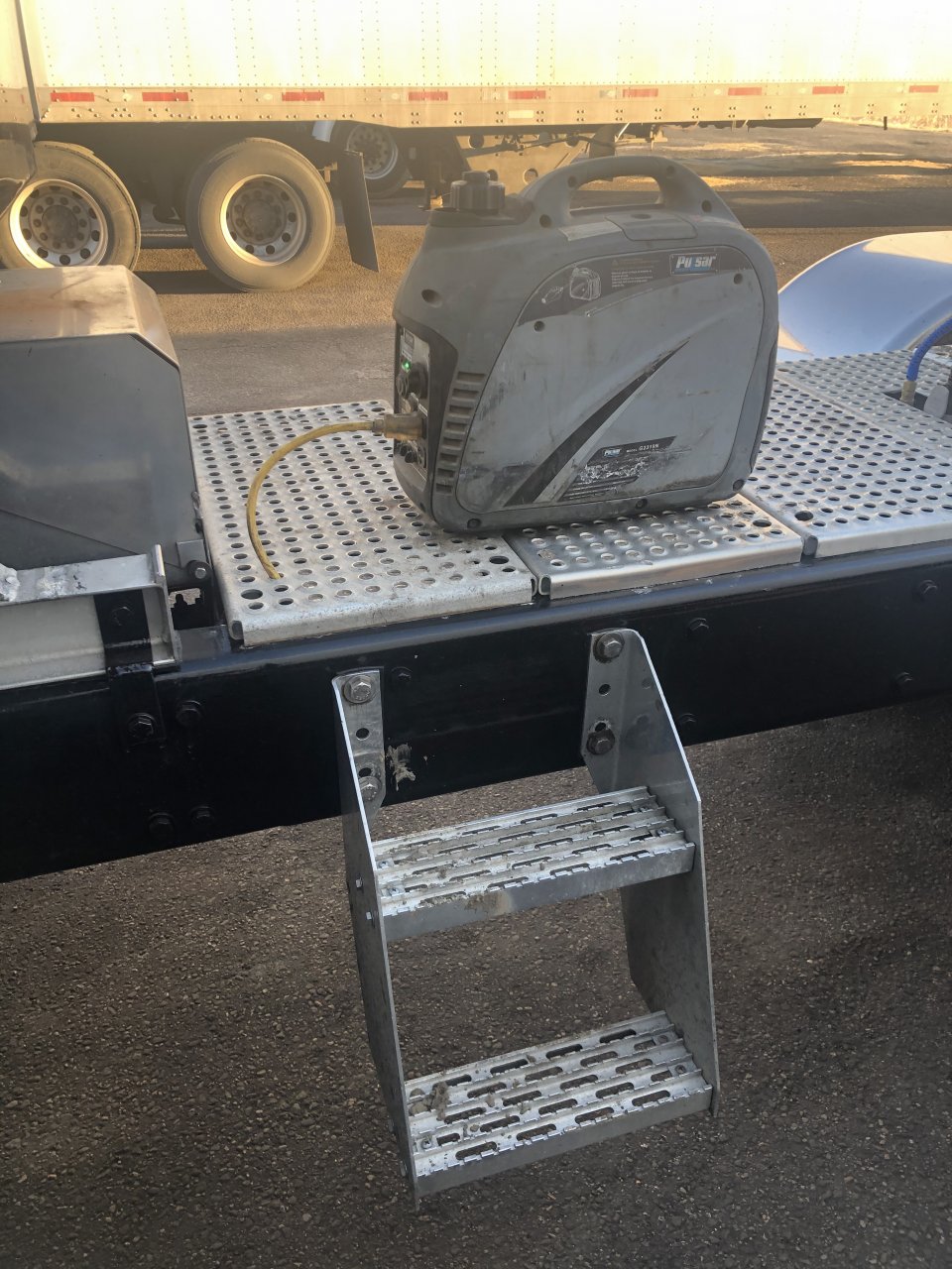

    I've been looking at different ways to mount my generator and I think for me it's best on my catwalk.
    My real question is about the exhaust. My truck is a flat top and the exhaust is short on my truck just barely above the roof.
    I can't put any higher pipes on my truck because until I raise my garage up it has to be that low for me to fit in.
    Is that high enough to run the exhaust from the generator?

    Sure. Mine sits on the catwalk for years. 10 hours a night every night. Just have the exhaust painted towards the trailer. I have a co detector. It’s never gone off in my truck, 6A533E7F-572F-4535-82B5-63C101FEDC23.jpeg

    I used to run that setup, make sure you run a exhaust away from your cab, and also get a fire and carbon monoxide detector inside your truck. You can buy your self a full aluminum box and put that generator in it. But make sure you let it breathe and not overheat.

    I bought a carbon monoxide smoke detector combo for twenty bucks. Don’t know why anybody would go without one. What about all the weed burner exhausts these days.

    I was reading a post that you had from a couple of years ago that you had it set up on your trailer with a champion 4250.
    You're not using that set up anymore?
    What you guys are saying I agree with. I myself would not put a generator on my catwalk and let it run. I'm not just concerned about me I'm concerned about anybody around me.
    There are some guys that mount a generator on their trailer and they figure well it's on the trailer it's behind me I don't have anything to worry about and they just let it run.
    But I started thinking today because I pulled into the truck stop headfirst which I normally do. I have a big fan in my truck and I roll the windows down and I enjoy the fresh air but if I did that and someone ran a generator back there they might kill me.
    And vice versa. I don't want to kill anyone else.
    So I don't know how high it is to the top of my stacks I'm guessing 10 feet?
    Is that safe at 10 feet if I just let it run back towards my trailer or or maybe on a 45?
    Like I said, I'm not just concerned about me I want to make sure anybody around me is safe and I am going to get a detector.
