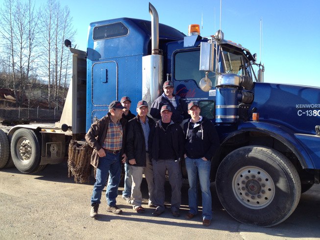

    These lights would only be 3" taller than my current clearance lights..
    Here it is...cab mounted instead of sleeper mounted but same idea/parts.
    K051-606-2POL and K051-606-2REOL are the KW part numbers. $463 each.
    The light is a Grote 76223 and about $115 each. Old mechanical/incandescent.

    The problem with mounting them on the roof of the cab is that they aren't visable from the rear due to the height of the sleeper. Can you have a pair of nice stainless brackets made and mount them to the top of your cab extenders? That way they are visable from all directions.
