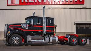

    Coffin is flattop
    Roughly speaking, if the cab roof and sleeper roof are the same height, thats flat roof, if the sleeper roof is higher, but not so high it doesnt need a wind dam attached to reach dry van height, its midroof.

    Examples
    In order
    Flattop
    Midroof
    Hi rise
