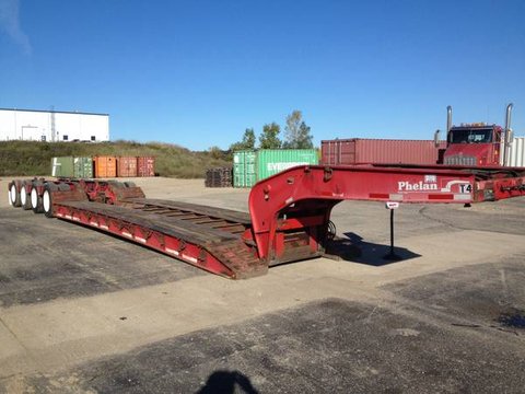

    Are you saying without blocks in you have 12" under the deck to the road? On mine if I pull the blocks I have 4" of clearance, that's low enough to run down the road. If I need lower for a short time I just retract the pins and let it on down but it's close to the fenders, I've been waiting on Talbert to join the band wagon and build a high arch neck. They do build what they call a ratchet neck now. It has a height adjustment like a Fontaine, a set of dogs that engage a set of notches controlled by a lever. They said they would even retro my trailer to that, I would like that instead of carrying different blocks. They did build a trailer for a while called a Phelan, it was a Talbert with a Fontaine style neck. From the neck back it was identical to a Talbert but the neck was A Fontaine clone, they didn't sell very well. I think Phelan was an old trailer company Talbert bought, I also think they had/have a big wig named Phalen so I don't know the real story.
    Here's a pic of one someone posted here a while back, from the neck back it's pure Talbert.

    Phelan trailers were built in Nashville,TN many years ago. They made a world of fixed neck dovetail trailers mostly used by dirtwork contractors to move their dozers and such. You still see quite a few of them around here on farms and such. They haven't been in business in quite a long time, one would assume Talbert ended up with the rights to the name somewhere along the way.
