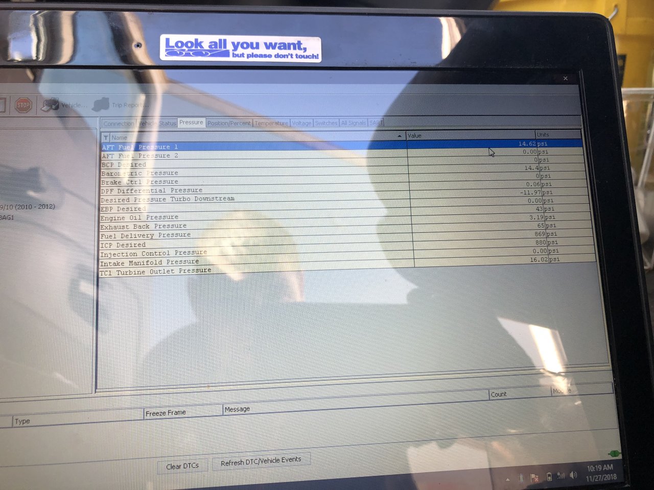

    2012 MaXxforce Dt no power no codes hooked up scanner to it and this is what he gets and ideas or tips on what the problem is ?? Truck runs and is hard to start with no power then sometimes u shut it down and restart truck and it runs better for 5-10 miles then back to the same problem thanks for any help

    These engines are bad about crankcase breather clogging up. Will cause high soot levels in turbo. Will cause low power no codes. May check that.

    Run an air management test and make sure it passes. Take it for a road test with a second person watching the laptop. Under full load rated speed you should be getting
    90 psi of fuel pressure
    36 psi of boost
    exhaust back pressure less than 53 psi
    Injection control pressure should match ICP desired
    DPF diff pressure less than 1.2 psi
    Right now you are at 65 psi of delivery pressure, should be 90.
