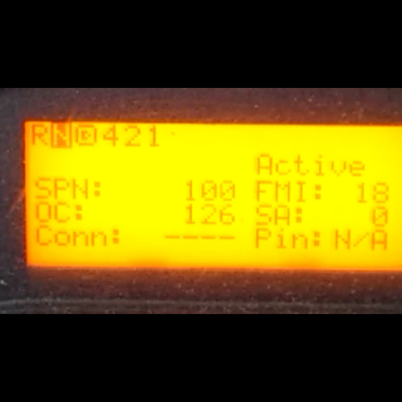

    Heavyd: My apologies. I may have gotten some of the codes wrong. I don't have the ServiceMaxx software, and am only able to do the cruise control button method. I did take some quick pictures of the codes that came up (sorry for the poor quality; I was in a rush!)
    IMG_20161102_202650.png IMG_20161102_202824.png IMG_20161102_202834.png IMG_20161102_202844.png IMG_20161102_202854.png

    Sorry Gordy, I cannot read any of those.
