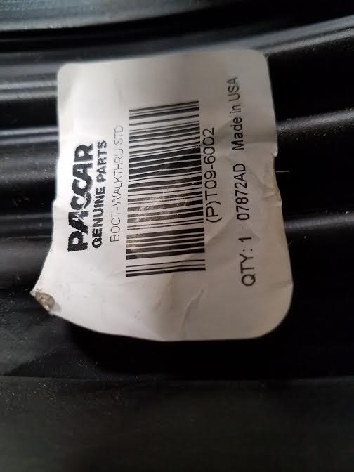

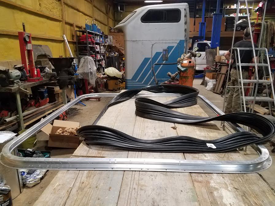

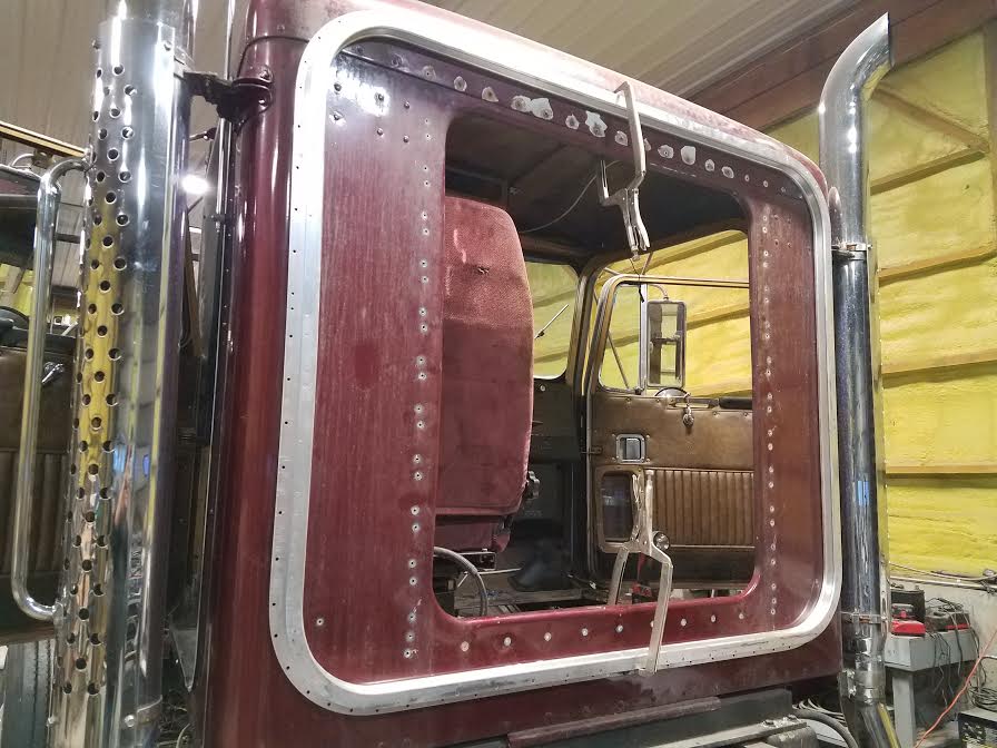

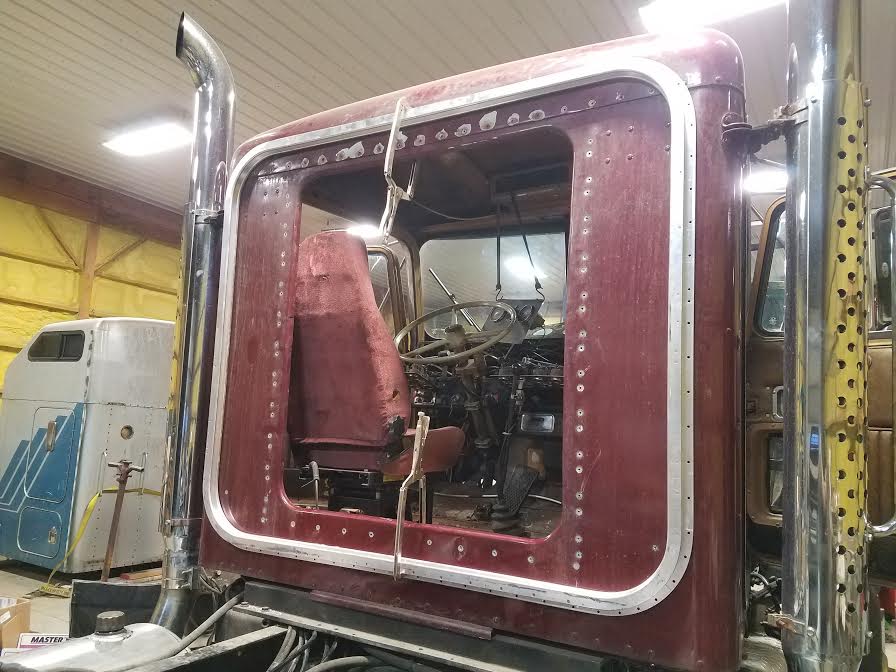

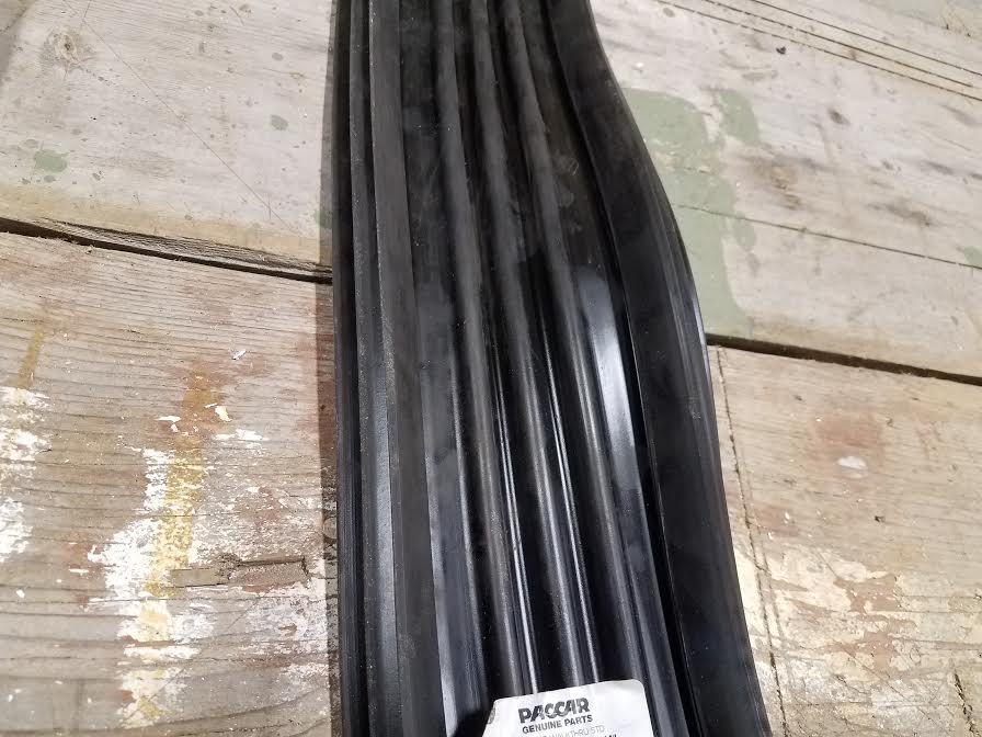

    So I came across this old thread from April 2016, and I'm right at this critical stage at this moment...ready to install the Peterbilt Unibilt frame rings in to make it a big hole, only in an A Model KW cab.
    We have the rings clamped up against the back of the cab right now, just eyeballing things. It's a little tough on this A Model cab, due to the height of the ring in conjunction with the bottom of it. We can't get it (the aluminum ring) any lower than it is in the pictures, as there's an aluminum "U" channel inside the cab which is a structural member that can't be compromised, nor should we have to. But the challenge is getting the Aerodyne II sleeper lower on the frame to match up with the overhang over the rear of the cab to look half way decent, so basically we're going to be dropping the sleeper mounts down on the frame, so the sleeper structure rails themselves will only be about an INCH off the top of the truck frame rail flanges to get the proper height and look.
    I have been contemplating the idea of cutting these rings in half and lowering the vertical height of them, so as not to have to remove so much material from the fiberglass roof cap of the A Model cab, and also it will enable us to raise the bottom mounting surface up as well. As an estimate, if we remove 8" of height out of the rings and weld them back together, that will take the difficulty out of fastening the bottom of the ring in the cab without interfering with that structural "U" channel member. I don't care so much about the height with this project, as I am focused on the width primarily to get the seats farther back for legroom. That's usually the case anyway with this job in most instances. I don't mind ducking a little to get in the bunk.
    The other question that 3 of us working on this job have also is, how the boot actually attaches to the rings. It just doesn't seem mathematically possible doing it on the bench, so we're obviously missing the mark somewhere.
    So, I'm looking around for ideas, and the world wide interweb usually provides pics and stories of about anything you need or want to know. I'd appreciate any input from guys that have actually DONE this job, so I can get some accurate info and keep it simple as well.
    Once that's determined, we can proceed to cut open the back of cab and front of bunk for the frame (rings) to be fastened in.
    Here's some pics of what and where we're at as of 24 hours ago: UnibiltRing&Boot #5.jpg
