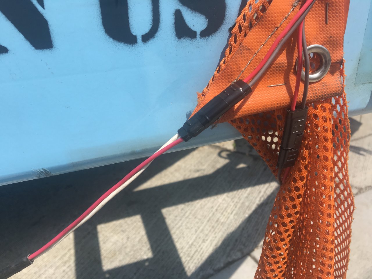

    I’m also going to throw my vote in for a wired set of lights. The Firefox lights are bright but they eat a set of 4 double a battery’s in less then 15 or so hours it seems. If I’m running lights I need them to work period.
    I probably have least then what 4 firefoxes cost ($200) in this wired set up I built to cover our 20’x60’ loads we move at night. Modular with 2 pin plugs and led 4” lights with magnets on the bottom. 18/2 sjoow cord. Everything stores in 2 plastic tubs.
    A0A7BCA9-E4EA-4D3D-A0B4-33C5FACE626C.jpeg 848C0E8A-C0F2-4FB1-BB34-3F950D32B244.jpeg
