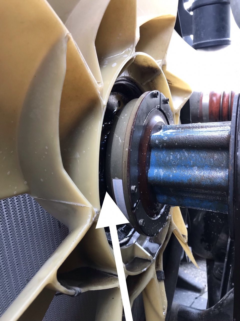

    hello fellow drivers. Like headline says, i’m losing Air pressure while driving. Did static, applied test no leak. I don’t lose any air in 10 hrs while truck is off. What can be the reason? What should i look for? I hope its not transmission.
    Primary air tank goes up to 125 psi and drops to 100 in 5 mins.
    Thank you!

    because it's not leaking when your on your break it is something that only has air when the key is on...
    lift the hood then turn the truck on (don't start it) and start checking....the fan hub would be the 1st thing to check.... look LISTEN and feel for the leak...

    I’ll definitely do that. The thing is I left it on for 30 min and it didn’t lose air (don’t know exact numbers but definitely not 5 psi per min). It seems to be losing while rolling.

    Two possibilities are the air dryer purge valve or the fan clutch. Put your hand over the purge valve. To check the fan clutch, turn on the key (engine off) and listen for the air leak under the hood.
