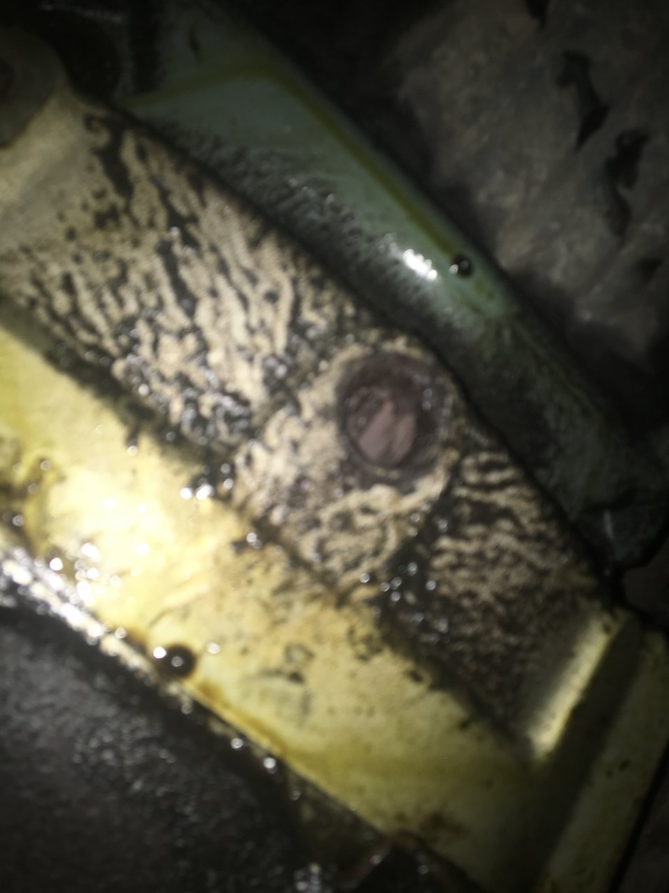

    So today I got my VPOD & turbo actuator checked everything was working properly. I went under my transmission and found this. A hole with thread around the opening and on the inside looks to be a gear. Should that hole be open like that? IMG_3598.JPG

    That's just your flywheel housing. Inside that hole is the flywheel, the teeth you see is the ring gear. Normal stuff.
    Thats just an inspection hole to look at the ring gear. Someone must of took out the plug and never put it back. No harm either way.
    Felix773 Thanks this.
