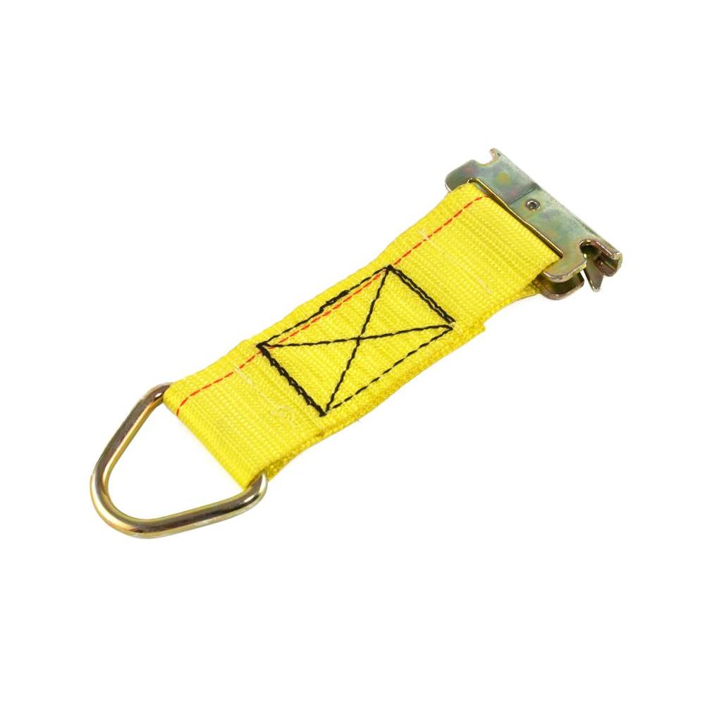

    E-Tracs are (usually) aluminum strips that run from the front of the box to the rear. Usually one low and one waist height or just below depending on your height, some have 3 rows. The ratchet straps associated with them have special locking fasteners on either end, not hooks. If you have then in your box, get at least one good quality strap and use that instead of a load bar.

    Apr 19, 2018
    load locks are not going to do much good unless you have the ends that lock into the e track van walls are to thin straps are much better at securing a load if you dont have e tracks you have to improvise and use a hammer nails and 2x4s most trailers have e tracks anymore. ......... if you happen to get good at securing loads theres some money to be made

    Load locks fail a lot when they are used in place of Shoring Bars. Shoring bars are specific to stopping forward movement of a load under deceleration stress.
    Hook straps made for small trailers and light loads will fail, so in place of those cheap crap, spend the right money and get the right strap.
    The E-track base are all metal and are made to distribute the forces, using hooks on them give a single point of contact and prone to failure.
