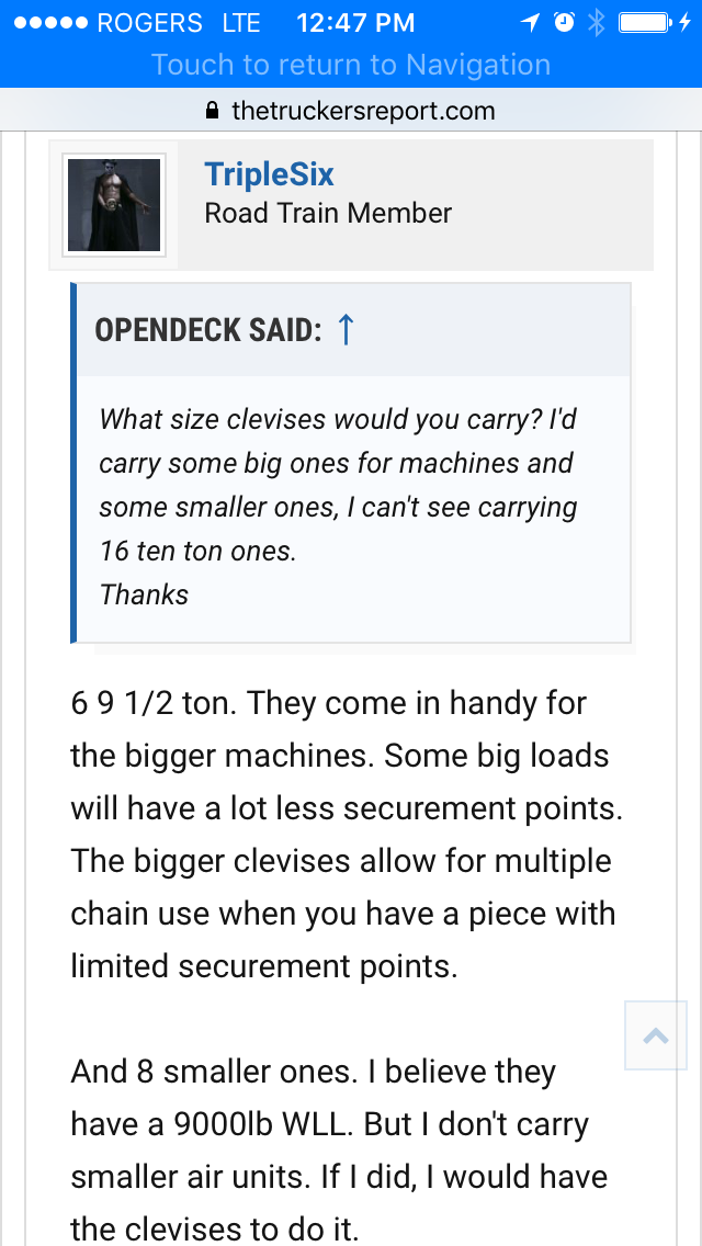

  6. Opendeck
    Opendeck Medium Load Member
    362
    2,698
    Dec 20, 2017
  7. Gunner75
    Gunner75 Road Train Member
    5,701
    9,073
    Mar 17, 2014
    Jackson Center Ohio
    kylefitzy, Broke Down 69 and cke Thank this.
  8. TripleSix
    18,316
    127,950
    I’ve used 10 ton clevises with 2 point securement for years. Never had an issue with DOT.
    1951 ford, stwik, BigBob410 and 5 others Thank this.
